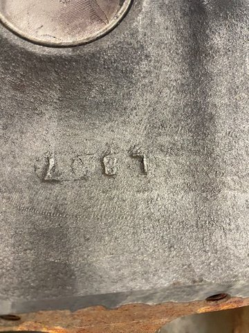

Here comes the good part, all my research it turns out to be a 1968 corvette block, 427/ 4 speed block.
Here are the casting numbers
Rear l.h. deck 3916321
Date code cast L8 7

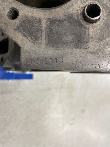

Front pad stamped outer F0219IR (the F letter i am not shure of, it seems like a T missing half of the top to the left)
Front pad stamped inner 18S413732
Hope someone can tell here and verify

Yes, it's 1968 Corvette 427/435hp block, cast in '67.
The left stamping begins with a T; all Corvette big blocks were cast and assembled at Tonawanda NY engine plant.
The 18S413732 is a partial VIN for the original car which designates 1968, St. Louis, #13,732 - these indicate it came in a Corvette as does the IR engine stamp for '68.

The IR code indicates a 435 HP 427. Solid lifter, tripower, rectangular head, 4 bolt main block. These were 4 speed only.
2898 were made in 68.
Should have a good forged steel crank too.
