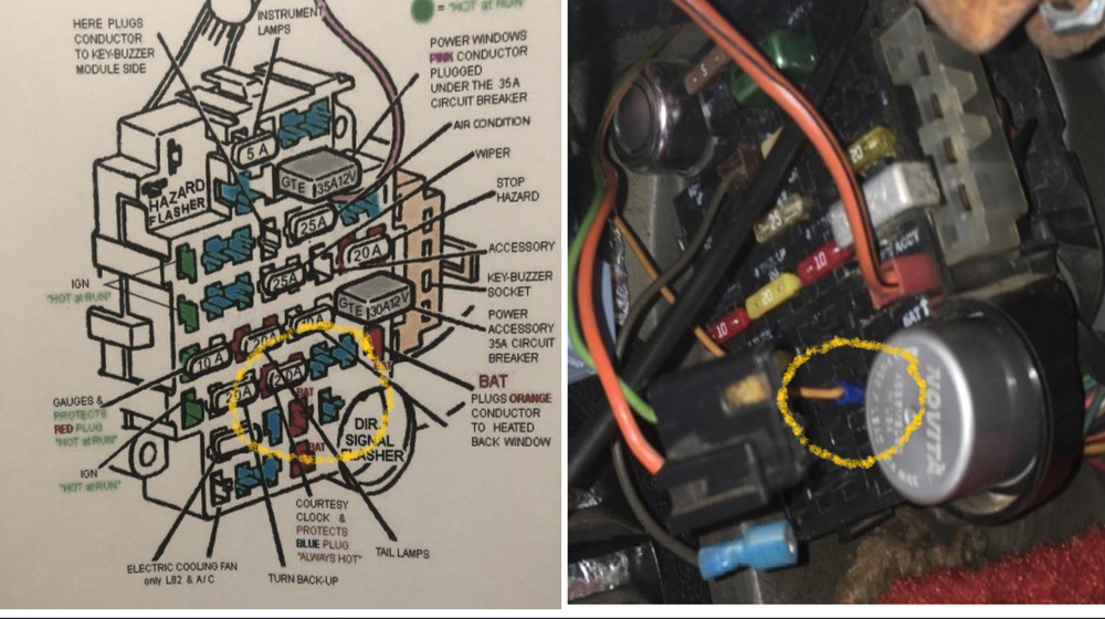

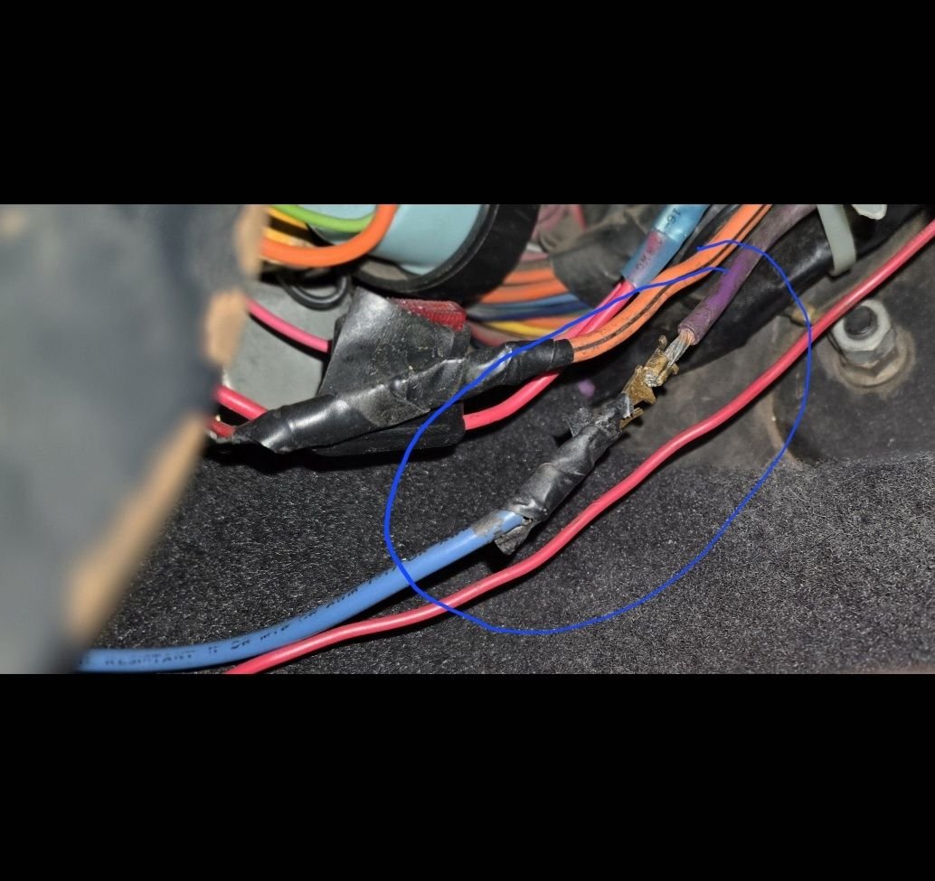

I was wondering if anybody knew what these wires were to? As well as that orange/blk wire coming into fuse box.
Thick blue wire into thick purple wire. Also that orange/black wire that feeds into fuse box.

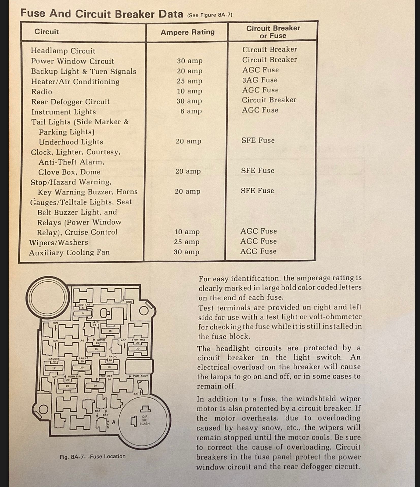

80 probably not far frm 79. You can get color diagrams here from manual
https://www.corvetteforum.com/forums...-in-color.html
orange white?

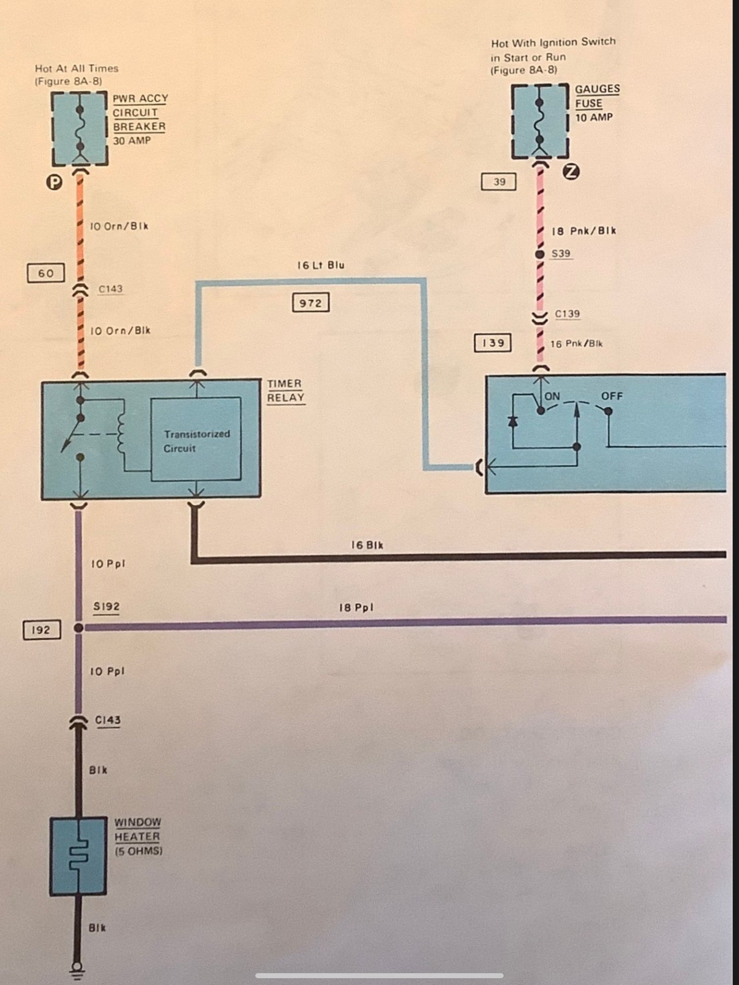

Thanks Interpon that might work. Looks to be defrost wire.
Old Nov 30, 2024 | 10:43 AM
rmrtrex's Avatar
rmrtrex
Joined: Apr 2021
Posts: 571
Likes: 101
From: Texas
Yes, it was the defrost wire. I guess previous owner had a problem with the timer and decided to bypass timer. I went ahead and taped the wires up. Will save that for a later project. Right now I have to to realign the windows and doors since it just got painted.
