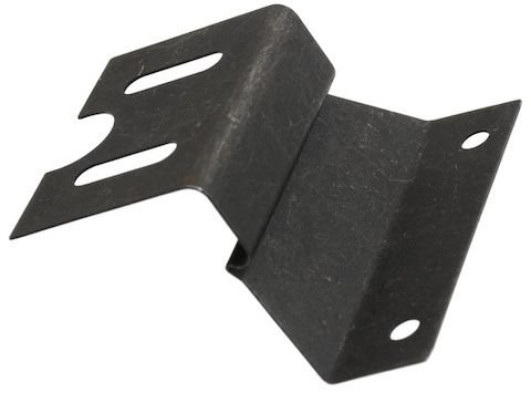

The thing about the window trays is that during the 5 year run, I think they changed 4 times! Did you buy a tray specific to 1970? The hardware for '70 should be the same as for '69 and part of '71. My '72's design changed to a push-button release like the 3 rear compartment doors, so I can't offer anything specific for the catch.
Do you have the assembly manual (AIM) for '70? It will show a diagram of all the parts of the hinge bolts/plastic bushings and the latch area.
The clip is being reproduced:
