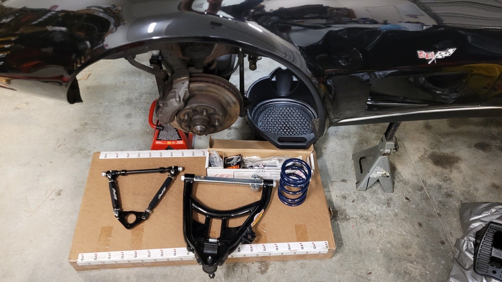

I pulled one side of the front suspension, and threw away the old A-arms, then found a different chassis. So the front left quarter of my 79 roller is sitting on a Global West front LCA, just so I can roll it around the garage. This is the one with the 2" drop specifically for coil overs.
I'm looking forward to getting some use out of them, in my other car, someday.
Originally Posted by Bikespace
Thanks!
Not much progress this weekend, but I did check to see if I have all the parts.
The Global West LCA's came with lower ball joints, which is nice.Looks like I'm missing one of the two SPC UCAs, so I need to track that down, not that I can do both sides of my car without turning it around...

I know this post is about Global West arms, but for comparison purposes, and looking at bikespace's picture, what advantage do the SPC curved upper arms have to the straight arms shown? Looks like there's more clearance. I note the straight arms (which I have) have no bump stop, maybe these
https://www.spcalignment.com/compone...tion&pid=97160
don't need it?
I didn't chase down much on GW uppers for comparison purposes, but it looks like they need shims to adjust? SPC's design seems like a considerable improvement.
don't need it?
I thought I was done with shims. SPC doesn't make a solution for the C5, so my SRIII chassis will need shims! Yuck,
I think the curved SPC arms provide more clearance, such that they don't hit the chassis before the limit of shock travel. The straight SPC arms likely don't hit, either, with semi coil-overs. It seems they are a bit shorter than stock shocks. I'll have to check again when everything is bolted up correctly.
