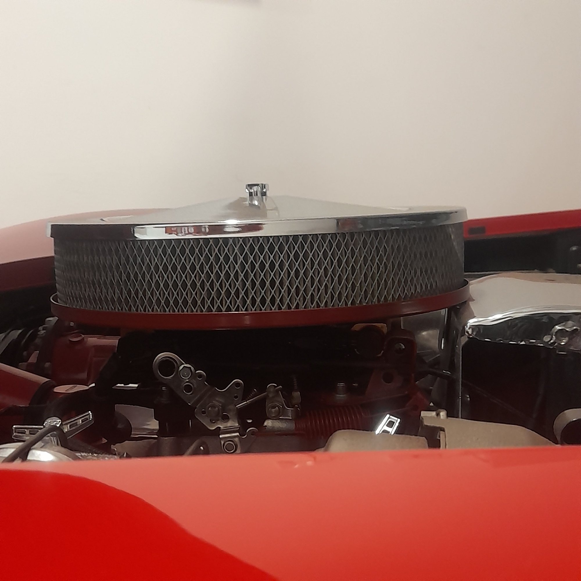

Army, I think you're leaving some horsepower on the table with that air cleaner.
Yeah, I know what you mean and you may be correct. I think 2" all the way around is good, as long as you have that two inches inside around the horn of the carb and I do. I measured that air cleaner with play dough, inside and hood clearance, the front is real close to the hood not mention the top. I have one of those filter tops and it hits, I bought two different drop bases-(this one has less drop than the other), 3 lids, filters, I even found a 10" to better fit the curve of the hood..no go with 3"-(anyone what my leftover air cleaner parts?)..
I had a fuel percolation problem and was getting fuel in the oil, when I got the car it was so diluted I was afraid of engine damage. To fix it I used a heat deflection plate and phenolic spacer, and a return line, the carb runs very cool now. Along with those I also have a Bowtie Overdrive TV cable bracket which mounts under the carb. Add in the 4 extra gaskets and the carb is raised about an inch...
Best I could do with what I have, if the intake ever comes off I'd certainly look into a lower one... Thanks!

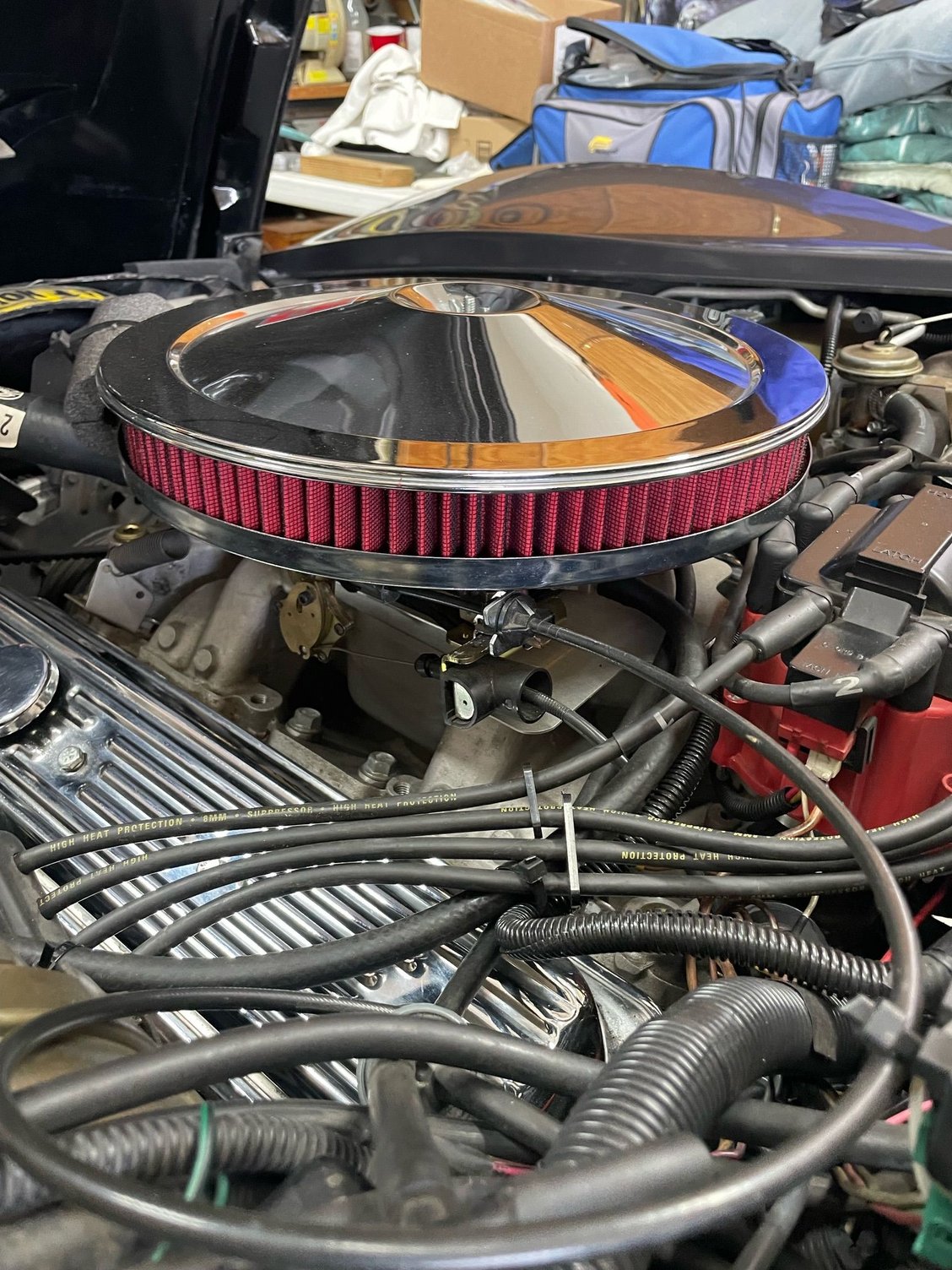

I couldn't tell what carburetor your had on there from the picture. I thought it may have been a Quadrajet. A few months ago I was watching Uncle Tony's garage and he mentioned that the Quadrajet was the worst for fuel perculation problems. In fact it was so bad that it was mandatory to run a cool can with that carburetor at the track. He said the problem with fuel perculation stems from the floatbowl being centrally located.

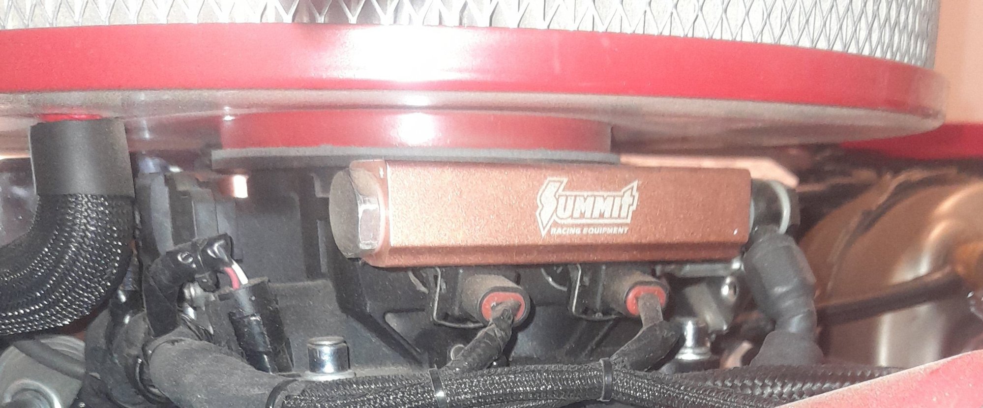

I looked into the Summit TBI system a while back. It has slightly less height then most carburetors.

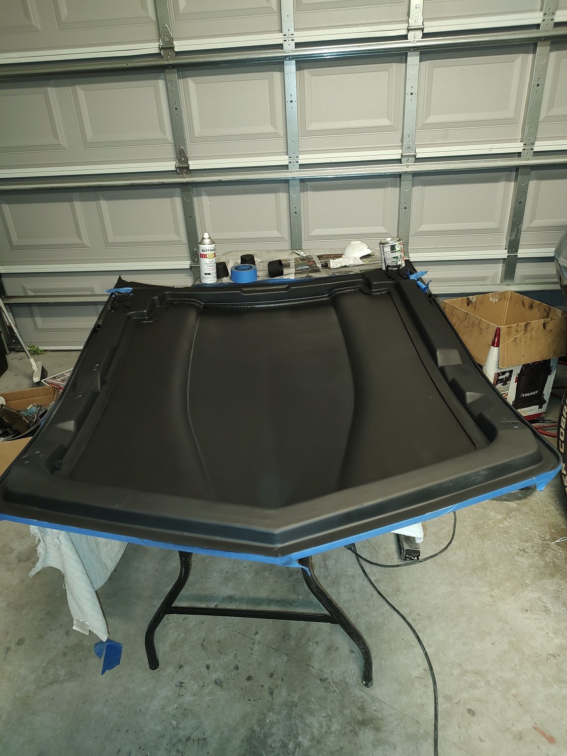

I cut out the ductwork for the crossfire quickly while I had a friend to help take the hood off and back on. I was concerned about clearance so I put a camera under the hood set to movie and put a styrofoam peanut on the top front of the air cleaner to see and to my surprise it looks like I have about 3/4" of clearance between the hood and the air cleaner.
Here is a screen shot of the peanut with the hood fully closed.
