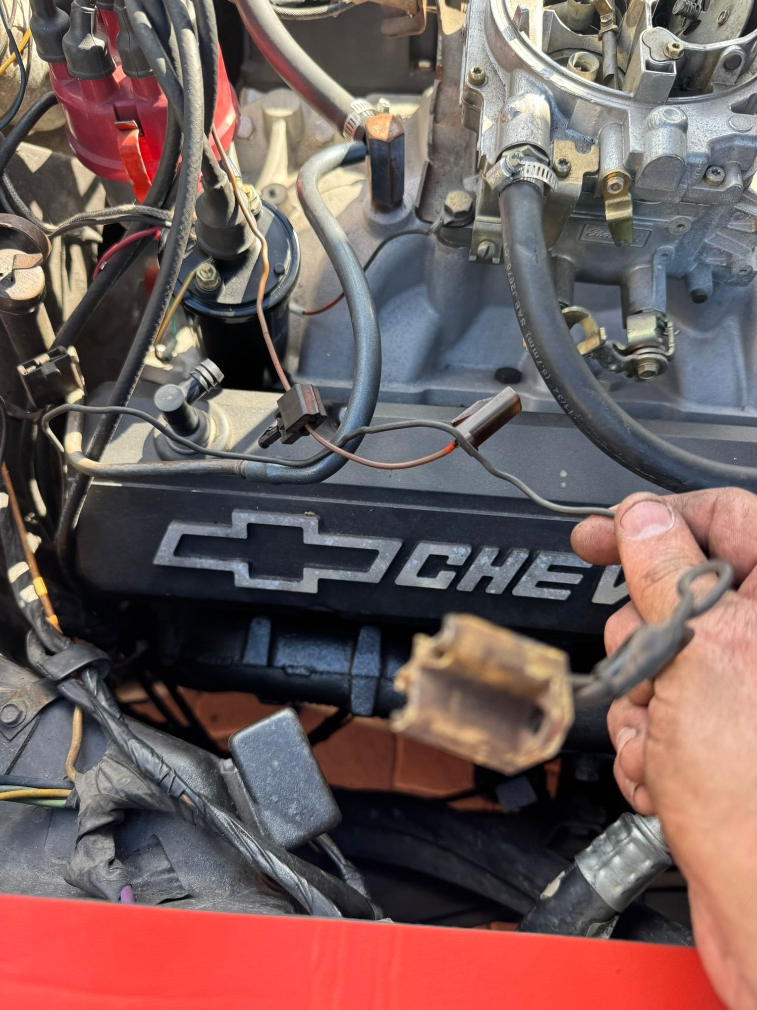

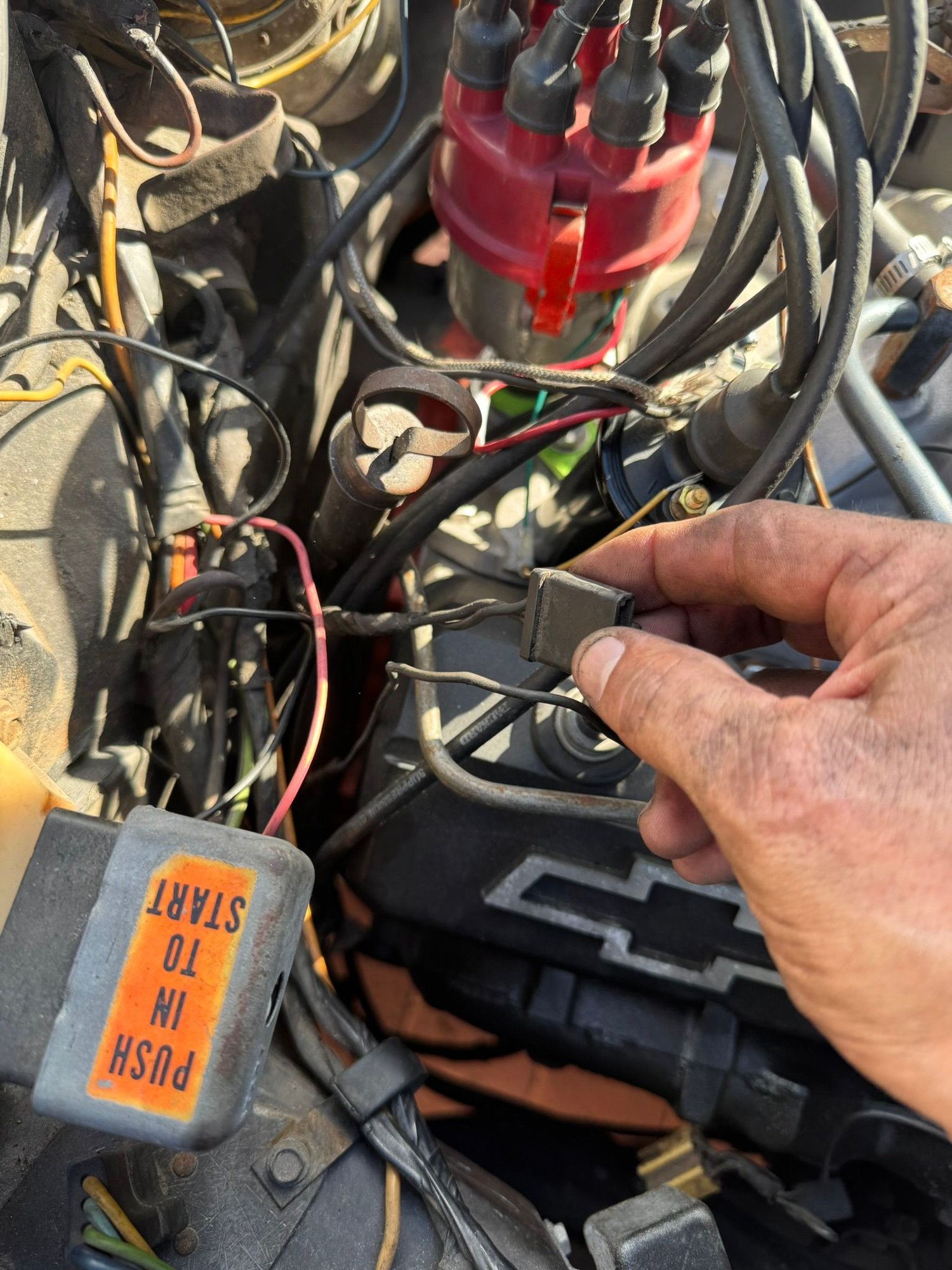

My friend just got his c3 back from 2 years at a crooked mechanic/bodyshop. they replaced heads and refurbished block, slapped in some garbage used carb etc etc etc. I got it running and plugged vac leaks still have MORE more to do. HOWEVER, I need to know if anyone can identify these cables that are loose. also, up front by the headlights, there are 2 plugs. one is empty and the other had that small module I show in the pic connected. Have no idea where that's from.

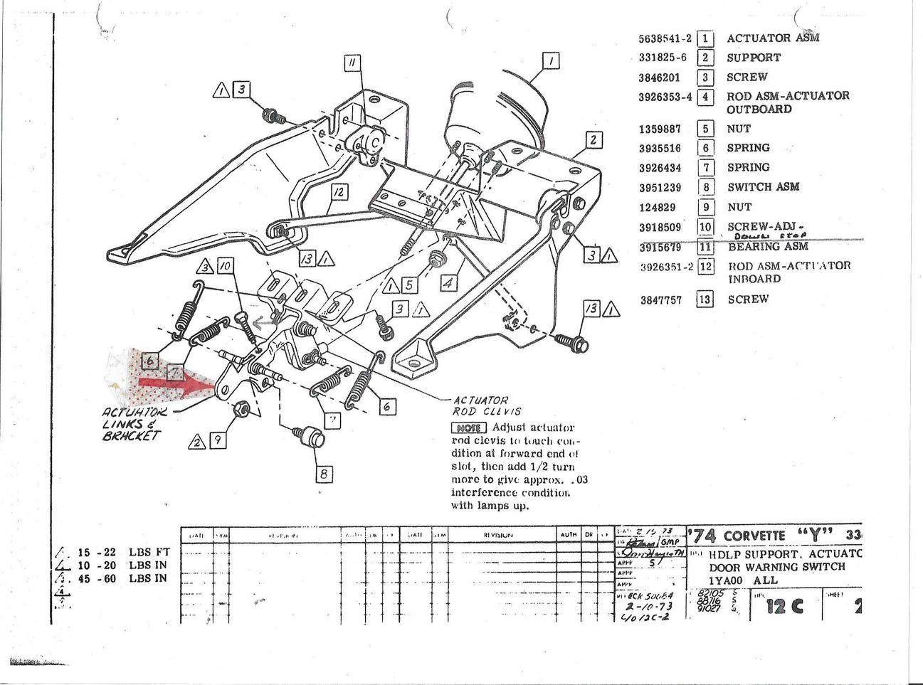

this is the plug up front by the headlights that small module came from

The part you have is a piece of the switch that tells you if the headlight doors are open and locked. There is a switch for each door, they tend to break quite easily.

Default The switch is #8
The plug in your last photo plugs into the switch at the headlight..

The wire in your hand with the loop green color is this going the the TCS Temp Sensor.
The Connector is your last photo.
https://www.zip-corvette.com/69-77-h...or-switch.html

the green wire is on the other side of where i'm standing and that IS connected to the temp sensor. the other wires are the ones i can't figure out at the moment. I am going to swap out his points for a new hei i have here and time it correctly after we swap the carb.
