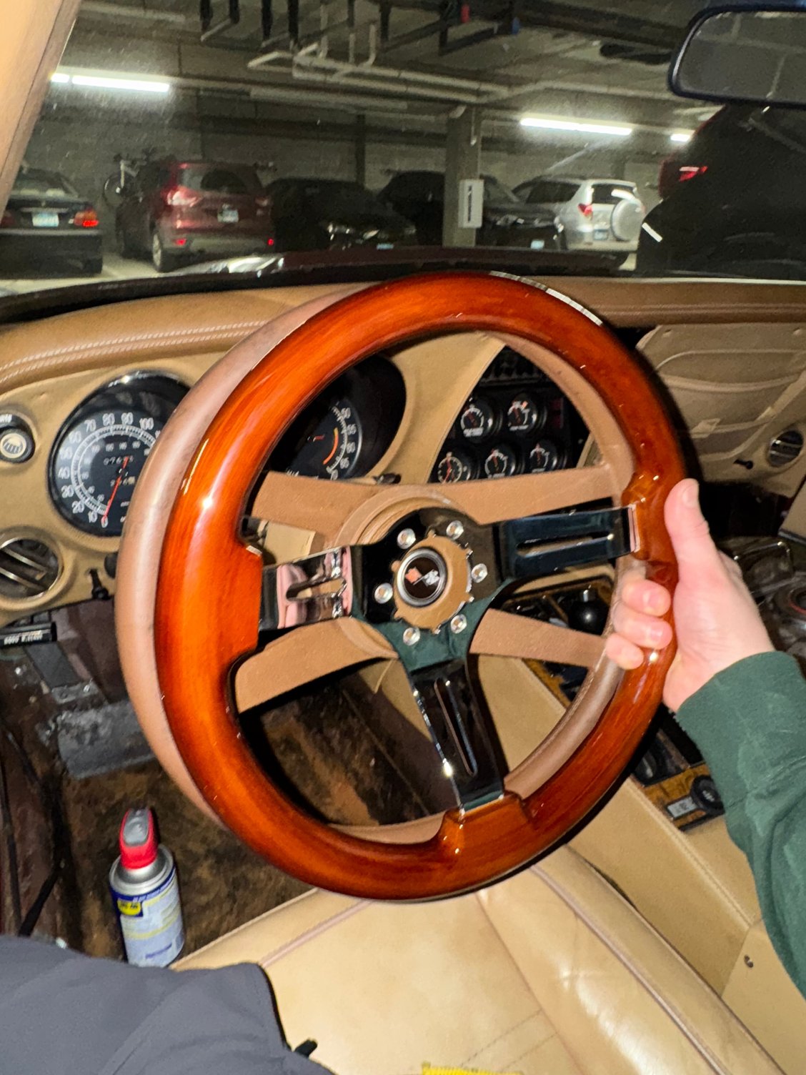

Old Dec 28, 2024 | 07:04 PM
Seadoorider's Avatar
Seadoorider
Joined: Aug 2020
Posts: 23
From: Kansas
Figured it out - yes I know the wheel has a C4 emblem on it - that’s what was sent with the kit - put it on there for now, will see if I can find one more C3 appropriate.
Nonetheless, wheel install went smoothly with the adapter kit and the new wheel is about 1.5” smaller in diameter than the Vega wheel.

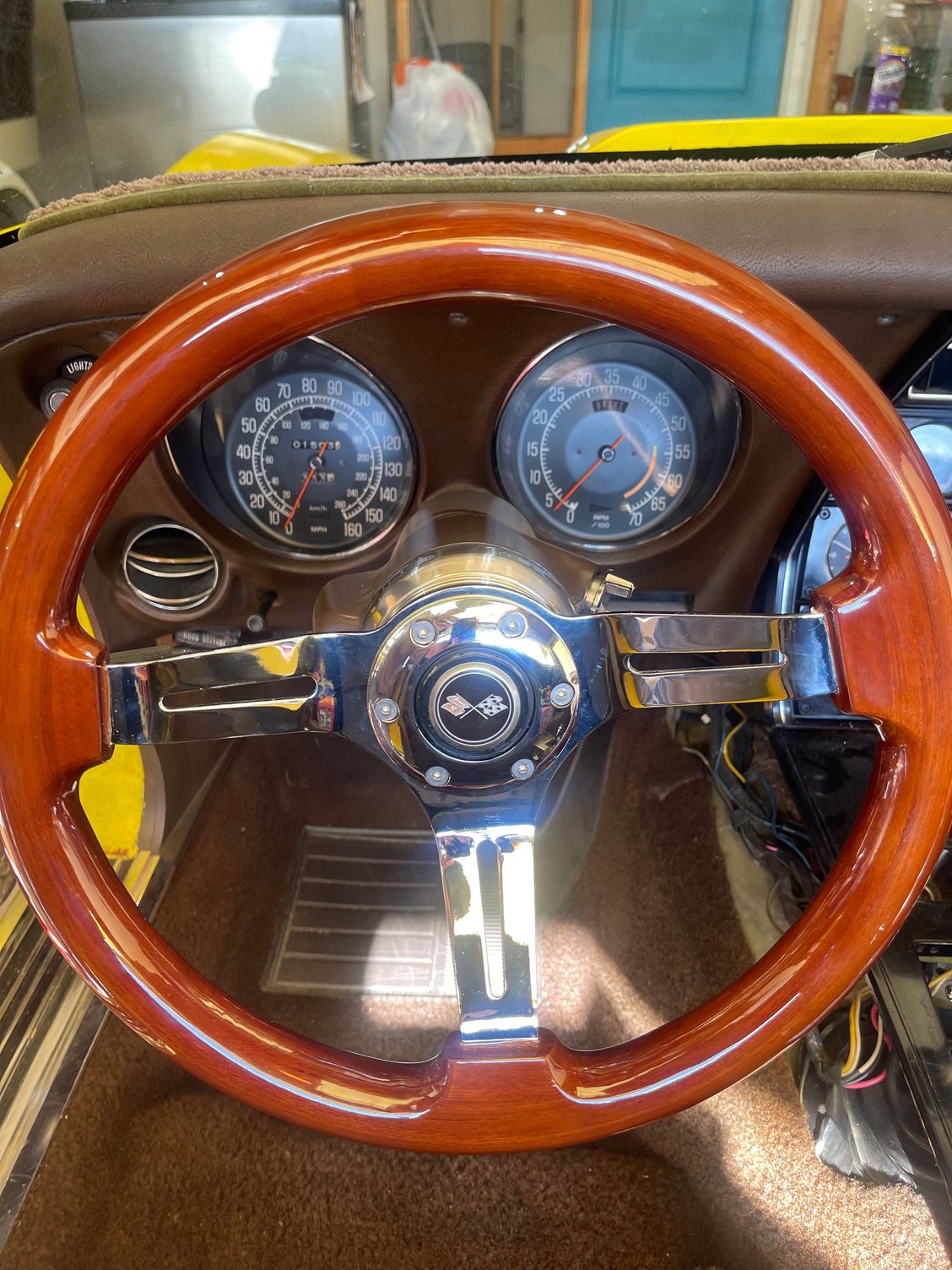

Old Dec 29, 2024 | 09:17 PM
Seadoorider
Joined: Aug 2020
Posts: 23
From: Kansas
Managed to repurpose the cross flag emblem from the 77 Vega wheel - had to grind a tab off but I think it suits the C3 better than the C4 emblem
