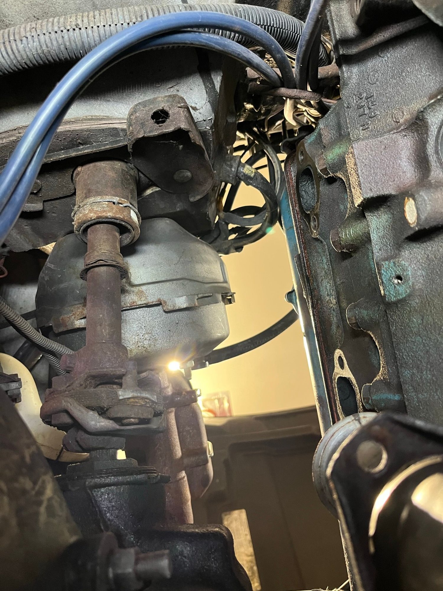

I am considering a Borgeson steering solution while I am swapping out exhaust with headers. Looking up into the engine bay I see this. Doesn't
look right to me. Can I get some comments please. I see a bearing that looks displaced and I see a steering rod that is off center. I would love some input here.

You need a new lower seal for the steering column. They are made of plastic and crack if old and run out of grease. They are easy to replace.

You need a new bearing. https://www.corvettecentral.com/c3-6...2bp%2523563075.

and would also comment that installing a Borgeson unit will not help this.
