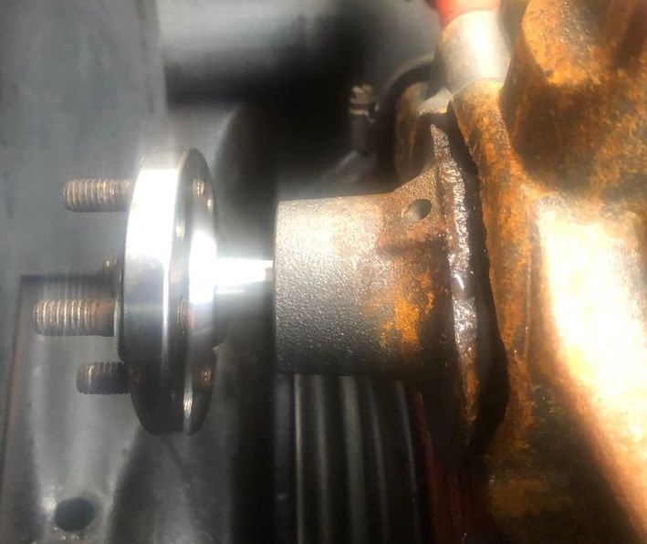

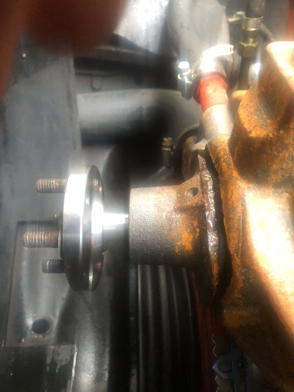

Joined: Dec 2024
Posts: 10
Old Dec 18, 2024 | 08:56 PM
Pdonovan115's Avatar
Pdonovan115
Cruising
Joined: Dec 2024
Posts: 10
Pdonovan115
Cruising
Joined: Dec 2024
Posts: 10

Old Dec 18, 2024 | 10:44 PM
barkingrats's Avatar
barkingrats
1967 Pedal Car Champion
Joined: Mar 2020
Posts: 9,137
Likes: 4,247
From: US-PNW
Originally Posted by Pdonovan115
I'm not sure what's going on, but two things look concerning to me: #1, that doesn't appear like a fresh crack - looks kinda rusty, as does the rest of the pump; #2, the fan mounting shaft looks like it's extended pretty far from the nose of the pump (might just be my mistake or angle of the pic).
If the pump was rebuilt by someone who didn't know how to support the nose to press out and in the bearings, I could see that sort of fracture in the casting.
Where is your mechanic sourcing these pumps? I think you'd be better served by getting one yourself from a reputable source.
