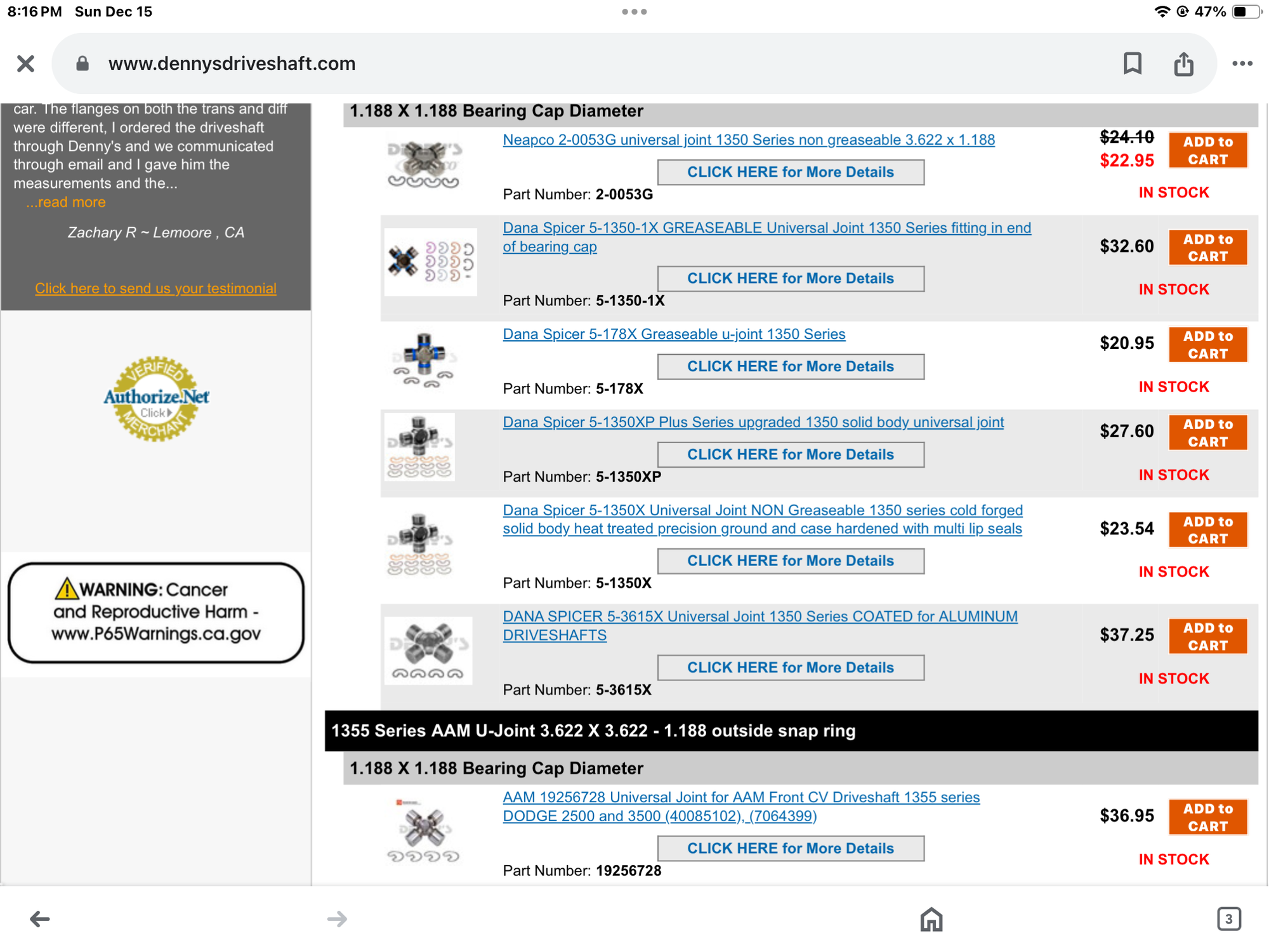

Alright so the spicer non-greasable 1330 and 1350 are the best? The is a bone-stock 74 L-82 (other than headers) which they say has 250 hp... so not worried about snapping a u joint. I found these on amazon for the best price... thanks for the recommendation!

FYI, buy from a place that will help you if you have any issues with the parts. I just bought 8 -1350's and they all had the wrong clips in them. Bought 4- 1310's and one was a zerk joint. The Spicer crosses are larger and will require fitting to get them installed. Any variation in the flange- slight bending, you will not get the clips installed and without the correct clips in the first place unless you have a surface grinder or clip stock, good luck.

been couple years but rockauto less than 120 for all 6
