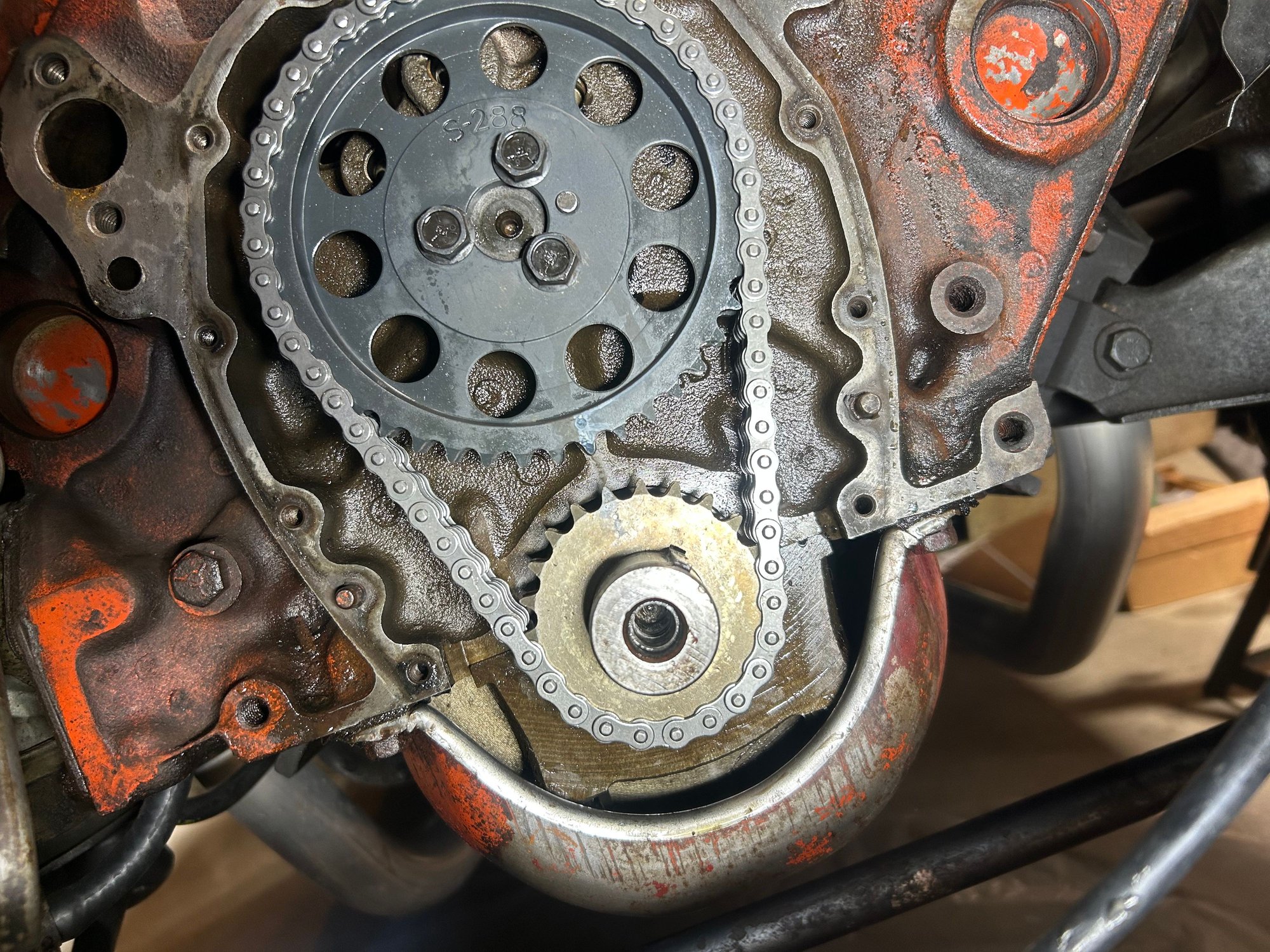

Default Cloyes 3023
I replaced the original nylon timing chain/gear set on my 300hp ‘69 last year. It now has a Cloyes 3023CK that is listed as a heavy duty double roller ($40 ish) The box was labeled Made in USA. My car is stock and not raced so going crazy with an expensive chain set wasn’t needed. There were also cases where certain high performance chain sets required clearancing on the block and that wasn’t for me. Do a ton of searches and reading before taking the job on. Invest in good pullers for the damper and crank gear. It is possible to do the job without pulling the pan which is what I did. But if I had the time the pan would have been dropped. I had not done a timing chain in over 40 years and it all goes smoothly if you read up and ask questions.
Before you take anything apart, take pictures of all the bolts and washers that hold brackets and the water pump. You’ll never remember what goes where even if you bag and label stuff. If I knew about the lockplate for the cam gear there would be one in this picture.
