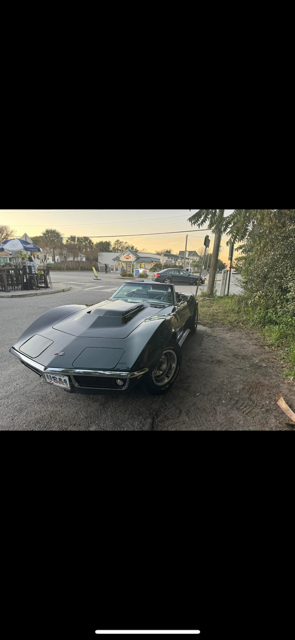

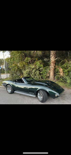

Thanks for your honest reply. I'm not really hung up on resale, I just dont want to do somehing that will F it up. My dad recenlty passed and lef this too me. He was a car guru and I am not. I love the car though and could you help more? Do you have Corvettes? How would you find someone to do this conversion? I added pics of my car, let me know if they didn't come through.
Thanks,
That's a beautiful C3 roadster. Your dad took great care of it, You're a lucky man.
