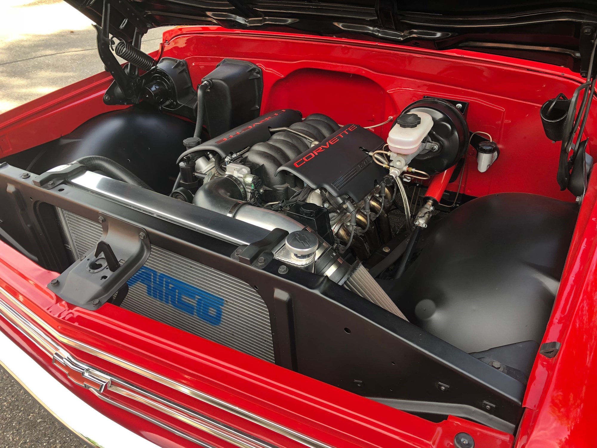

On my 68 C10 with LS6/T56 combo I used a 3/4" Wilwood master. Worked great. Depending on the pedal throw you need to confirm pedal travel does not over extend the slave. Hard line (nicopp brake line) from the master to a -3 SS flex line to the slave. The clutch line needs some flex due to engine movement.
Pic of my C10 brake master.
