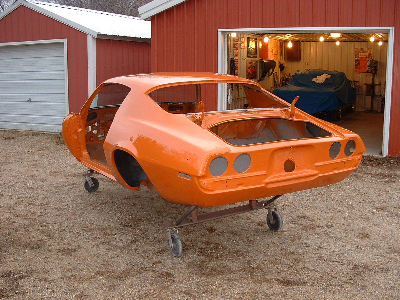

Just a thought.
If you have the fab skills along with a welder I would build a dolly that the shop could bolt on after the diff and trailing arms are removed.
Kind of like my 73 Camaro project.
Use big casters. They roll so much easier over rough ground.

A mini version of a chassis dolly for example. 4 wheels would make it stable.
4 ratchet straps to the rear frame would keep it from moving/twisting.

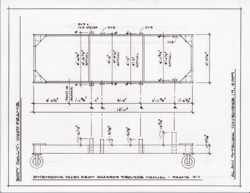

Here are the plans Alan made for the body dolly above.
At least it gives you some basic dimensions.
I suggest attaching it to the rear crossmember and side rails as circled below, because I know you can get a strap thru those locations, between the frame and the body.
I strongly DO NOT recommend the jackstand method. They would be far too wobbly for what you intend, and the furniture dolly wheels are far too small.
But the height is nice.
I circled where I know you have about 1" between the frame and the body.

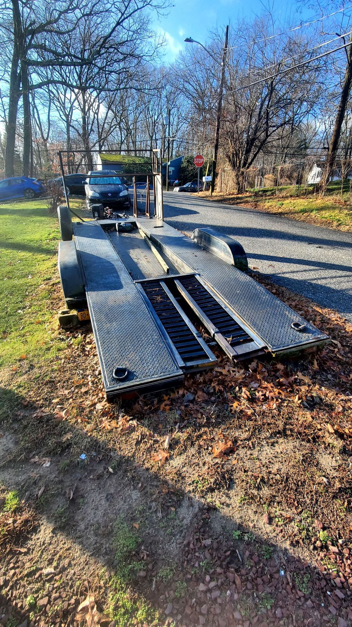

See Pic for the trailer

Yes, use a couple of sheets of plywood across those ramps and it will go on the trailer easily. You may need a small piece of 1/2" to make a ramp up onto the 3/4" ply.
