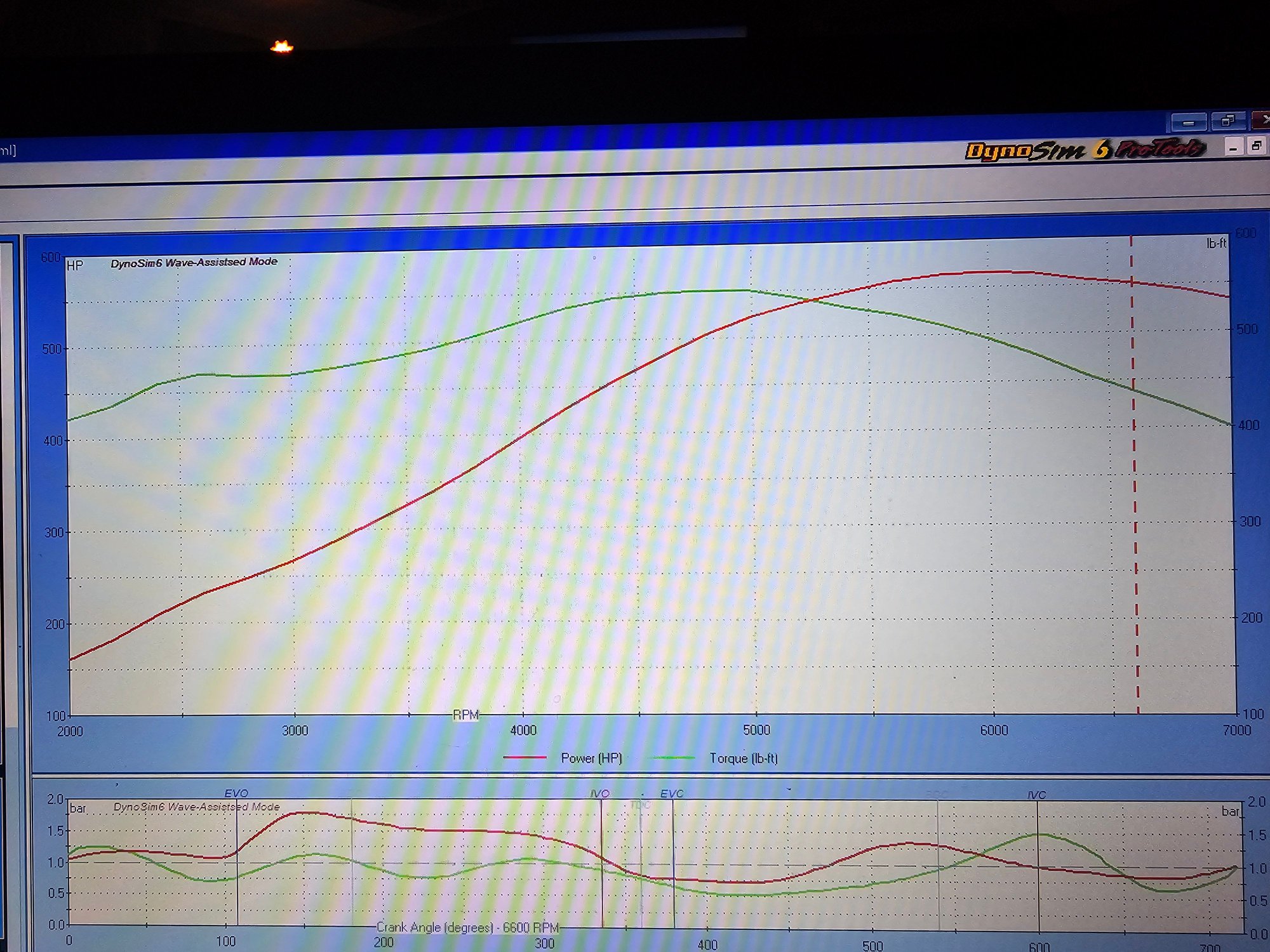

These are what my numbers look like with a similar cam profile to yours with my 1.8 rockers.
What is your compression ratio and what are the specs on those Edelbrock heads? I know my 396 with the same cam on stock heads was a complete dog, but just swapping on my Brodix 270s, that motor would rev like a 327 on steroids...these heads are magnificient. I just dont know what they will flow for engine displacement requirements

This is great data Mr Rogers (I live in a town called Rescue-kinda funny). Who did the FEA on this? Pretty compelling correlation to port velocity and power development. We (my somewhat educated and decently practiced tribe) all kind of anectdotally understand that suspended fuel particualte, remains that way as a function of velocity, but its just super bad *** to see it this clearly illustrated. I really appreciate you posting this up. If you do not object, I am going to use this as a teaching tool. I just did a long sit down with my son, explaining valve event timing. I was not getting through super well. The 1/2 speed relationships etc. Then it dawned on me. First, that I am actually a dumb, horny animal (proves my mother-in law is indeed correct-that bitch) and that an engine does not recognize anything but time. At least in relationship to events. Whatever needs to happen has to happen within a limited amount of time. So I took a clock and marked it in degrees, just above the numbers. Bingo. Lift and duration now make sense. To wit he says, "Is that why we have roller cams and followers, because with really high lift and duration, the angles are really steep and the other kinds wont follow as good without impossible spring pressures?" I wept openly...My son ladies and gentlemen.......My son.

feel free.... You should get yourself a Dyno Sim. I think mine is DynoSim 6. YOu can learn alot just from changing flow datat or cam data to see where things fluctuate from small changes. The second video I posted from Richard he exp0lains alot about mid range flow numbers where we live most of the time so you see why the numbers and HP goes up. I spend a lot of time studying and learning about this stuff and came up with my build by myself....I would have gone with AFR full CNC if I had that kind of cash, It took me a while to save up for those Race Rites..I also have a highly modified tripower setup. Its still the same cfm and oval port intake but I have mechanical linkage and accelerator pumps on all 3 carbs
