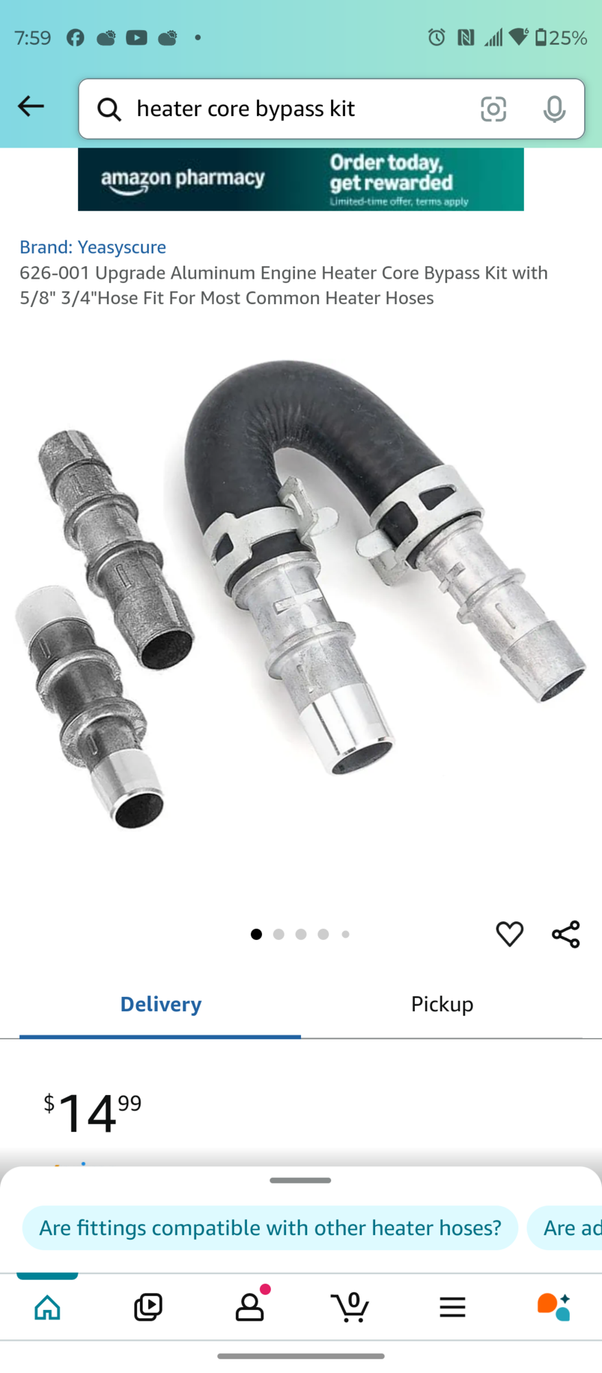

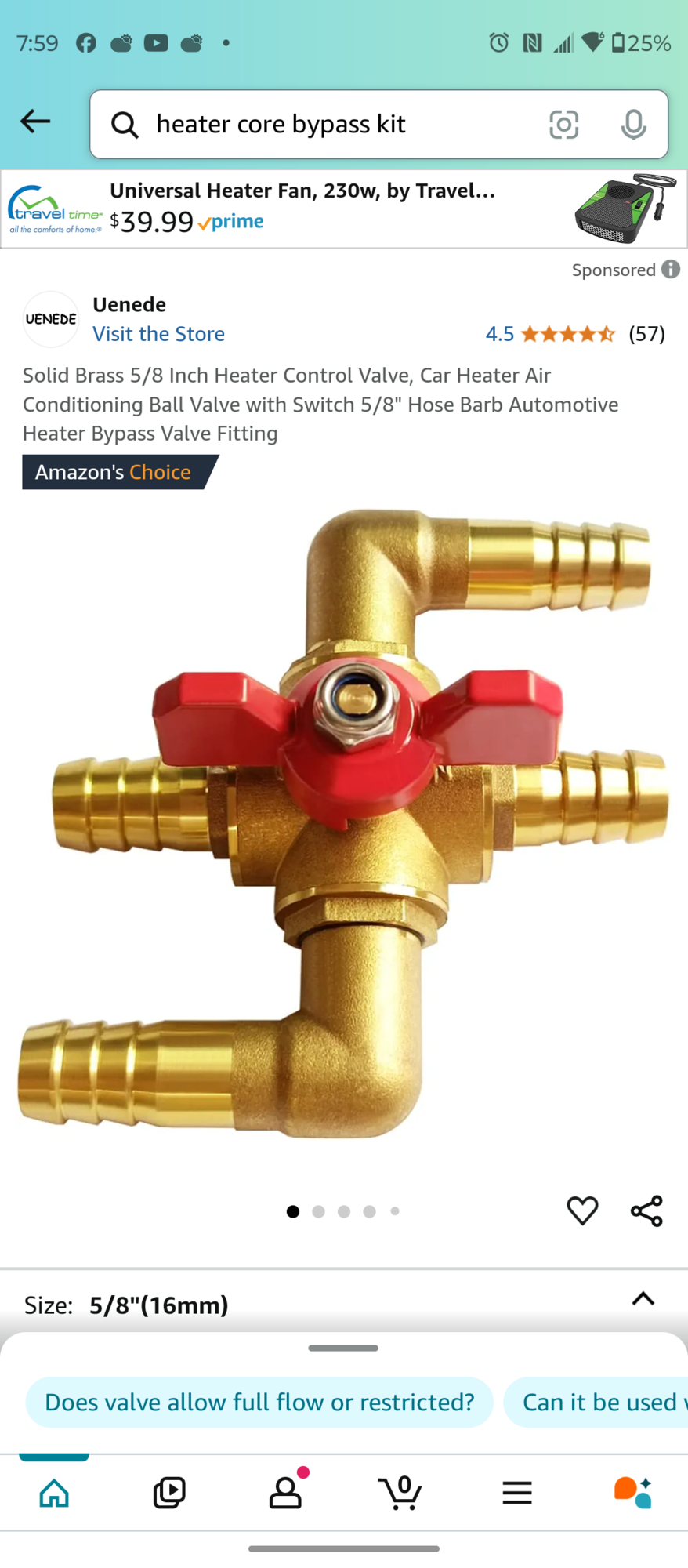

7 psi cap is easy just about any parts store special order (probably) including Amazon. The problem is you won't find it as a look up for the car, So I would say you take your cap to a good store and take a risk and match up a cap that would work.
Now the down side of a 7psi you will lower your boil over and in a big block that's Not Hard in traffic.
I think you would be better off with a heater hose loop or shut off that can keep the pressure under the hood
