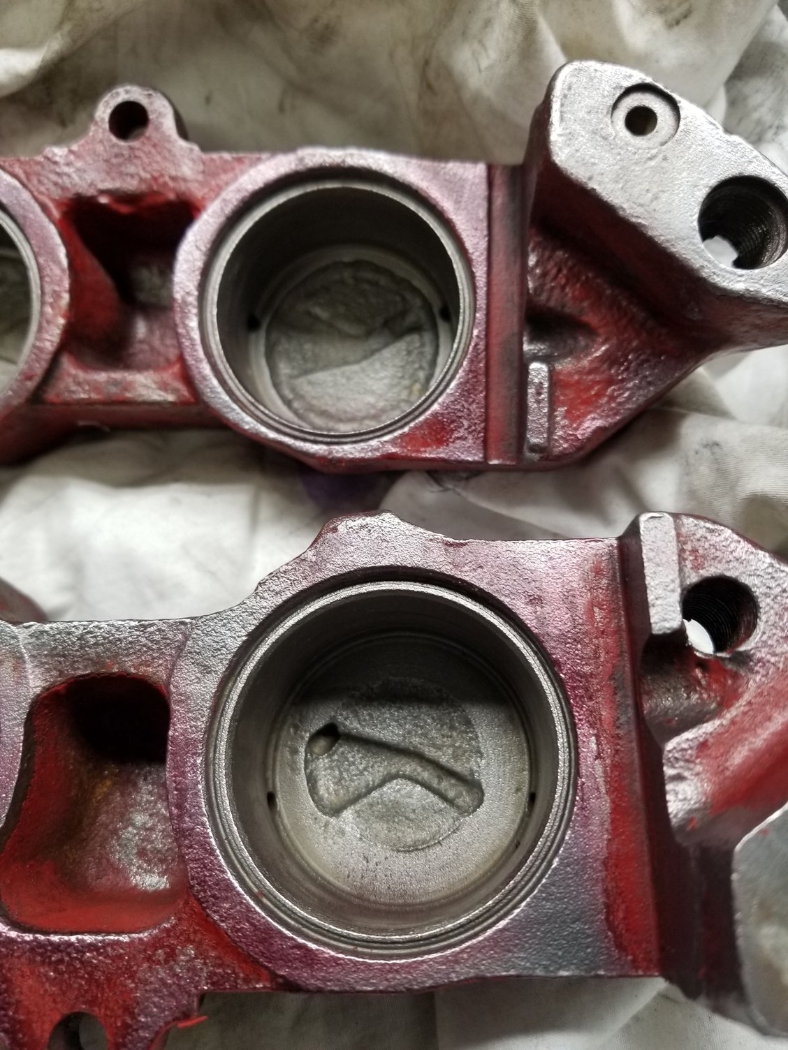

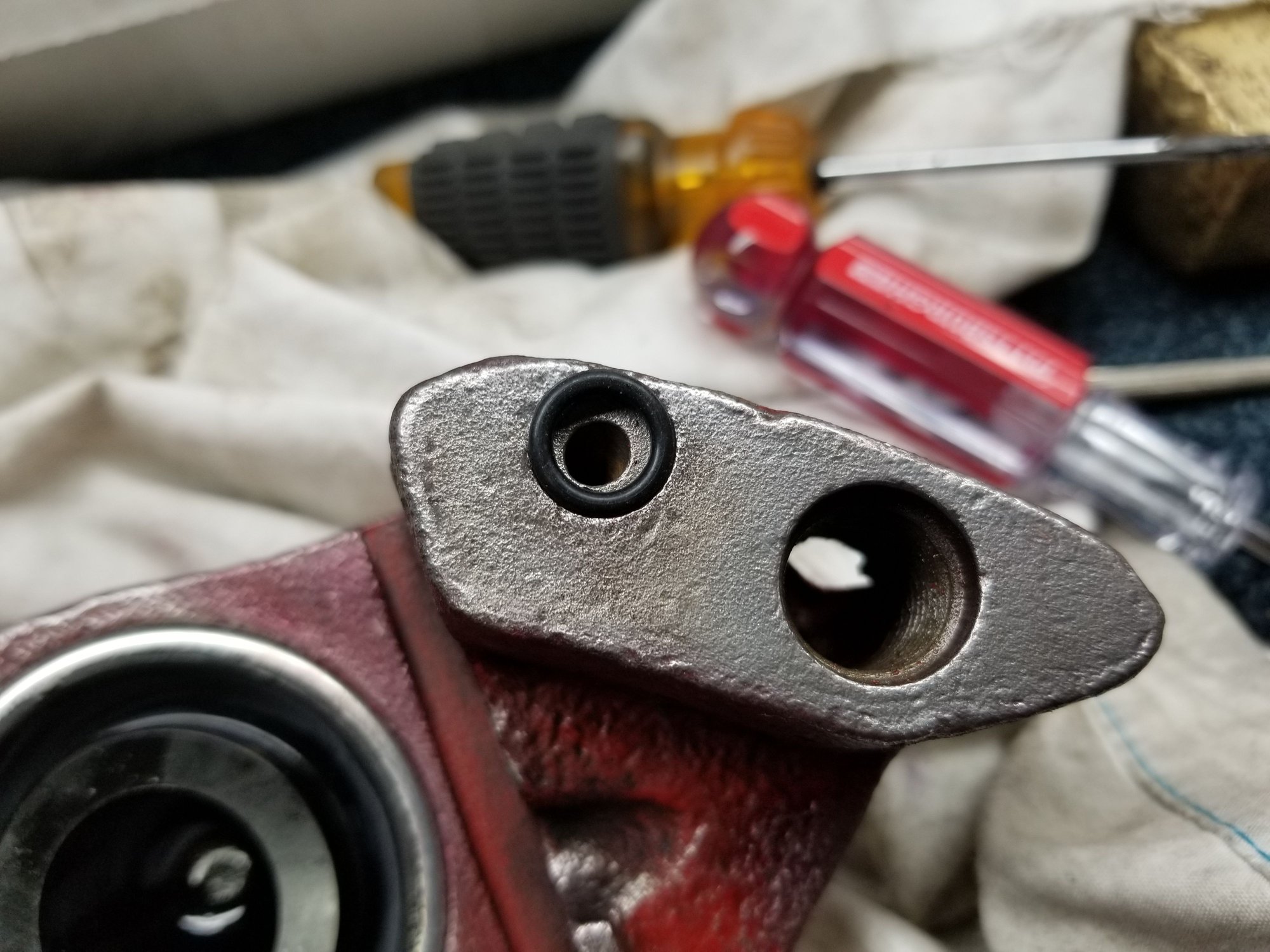

So to be clear, these are all sleeved calipers with the O-rings. The leaks are all coming from the seal between the caliper halves. When I disassembled the first ones I found crud and corrosion on the mating surfaces which I cleaned up with a wire brush and scotch Brites. The recess for the small o-ring looked shallow but decent enough to make the seal so I torqued them together and assumed it would work. The one that was leaking is now fine but the other one that wasn't leaking is now leaking. I don't want to go through this again so I'd like to find a source for reliable, well built calipers. I'm guessing Lonestar will be my best bet..

It isn't the runout and it isn't the pistons that are leaking. In all cases it is the small o-ring between the caliper halves that is leaking. I had my assistant apply full pressure after bleeding and it leaked then before we even put a wheel on. I'll just try to get new Delco castings with the O-ring upgrade for the pistons and leave the dry side alone. I was just hoping that there is a little known solution like a better type of seal or a machining process that would help that I hadn't seen in my search. Thank you all again.

I cleaned up the mating surfaces with a metal file for a clean smooth surface, applied a little clean brake fluid to the o ring, bolted both halves together and have had no issues with leaking.

As for the OP's issue, it seems that once significant corrosion gets into the o-ring pocket between the halves, that caliper is done. Perhaps it could be machined, and a larger O-ring used? You can see the pitting starting in @Rescue Rogers' images above. Fortunately, the O-ring is still working.
The stainless sleeving of our calipers was done to fix the corrosion problem in the bores, It seems that rather than solve the between the halves corrosion, current rebuilders will just warranty out the calipers, or use new castings.
