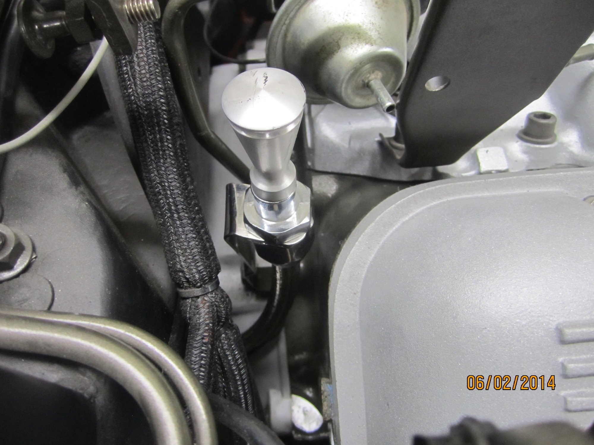

Pretty sure that’s the one I used back when I had my ‘69 (but in raw aluminum finish). You can see it back there bolted to the firewall. I forget what all I had to do to make it work as that was maybe 15 years ago, but it did work.

It worked fine for me. I used one on my th400 but I made a bracket to attach to one of the bellhousing bolts so it's more or less back where it should be
The other style is designed to bolt to a firewall and I didn't want to go that route
