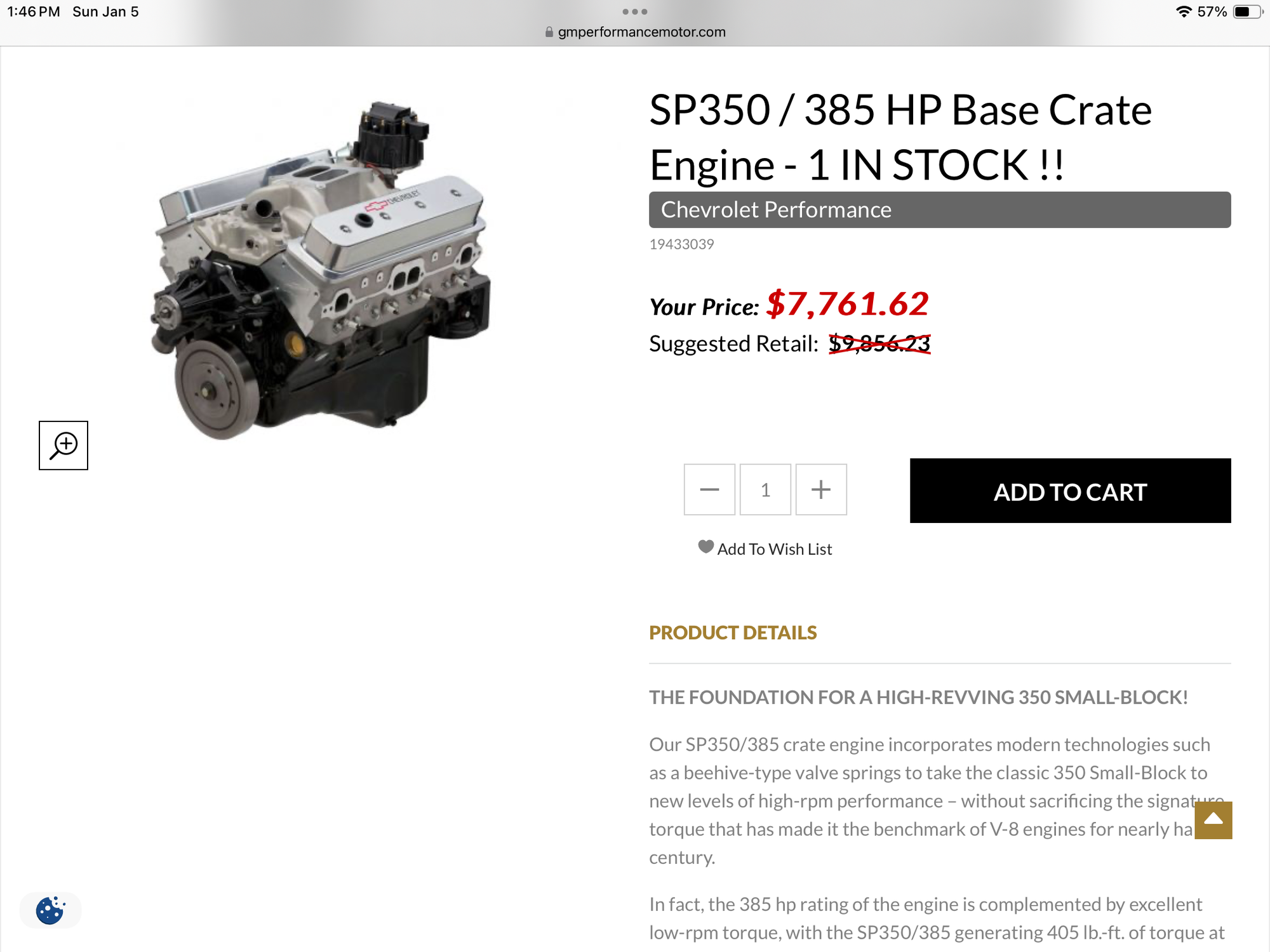

Old Jan 5, 2025 | 01:49 PM

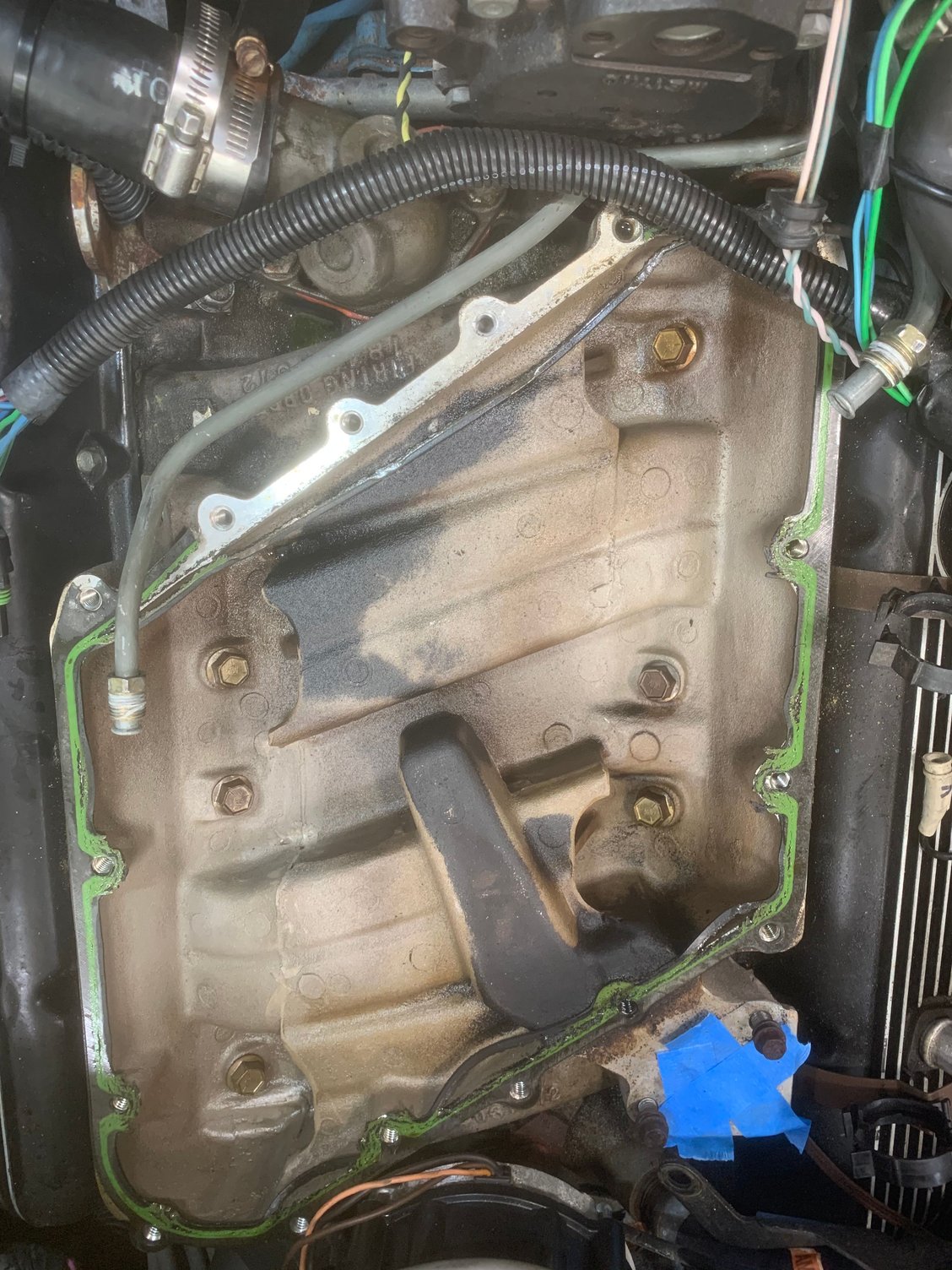

My 82 upgrade….it was used but very low miles.
