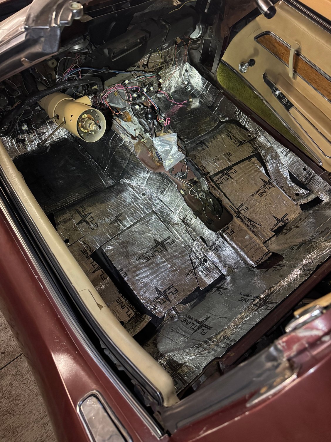

There should be some jute padding attached to the cabin side of the firewall. After 50 years it’s probably pretty smelly and worn down. I would replace it with some new stuff or just remove it entirely. Oh and be careful not to bend the upper dash pad too much taking it out. Mine didn’t survive the heat.
New insulation and LED lightbulbs
