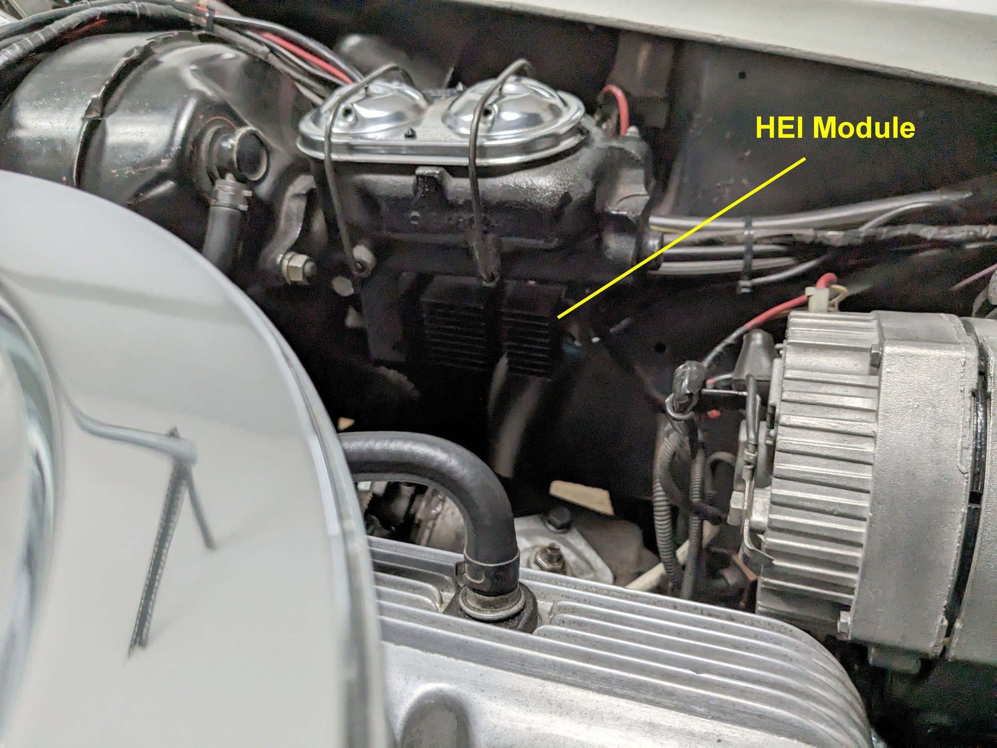

I'm sort of doing what you want. My TI ignition module failed, so I replaced the TI module with an HEI module. My distributor generates a mag pulse, same as an HEI.
I mounted the HEI module to a heat sink and mounted it under the Master cylinder. It's been that way for a few years.
I carry a spare HEI module (mounted to a heatsink), so if I have a module failure, I can change the module in a few minutes.

Barry,
Sorry for the ignorance, what is a “TI”?
Since you are using an ICM outside an HEI head, apparently they will work in an open environment.
Thanks for the info.
I also have a 3x3 section of finned heat sink from another project I had a while back. I had not thought of attaching the module to heat sink.
When I pull my intake for freshening this spring, I will relocate my ICM, attach it to the heat sink, and mount it in an accessible
place under my hood to see how that works.
