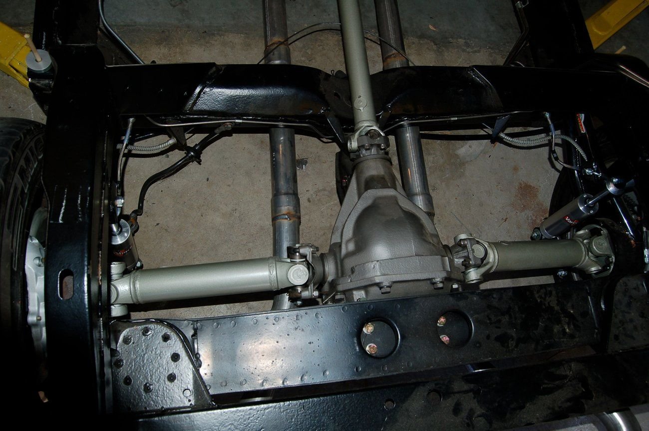

curious, how do you recenter a diff ? I just had mine out for rebuild and there was zero movement once all three bolts are in going back in. Unless it's a different set up than my 81 and you can move it around before tighten up the bolts?

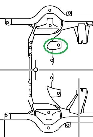

Yeah that was my question too. Not sure what bolts you are referring to but here's how the diff is located. Once the body is back on, those bolts are very much not easily accessible.
on my diff bolts I was referring to the bat wing bolts and front bushing bolt , you can't move that diff at all when the bolts are in , I think it's a war story that the alignment guy said he recentered the differential , not to mention it really is not a big deal aligning a vette if the rear shims are not all rotted , you set the camber with the eccentric bolts then move shims from one side of the trailering arm to the other if necessary to set the toe.
