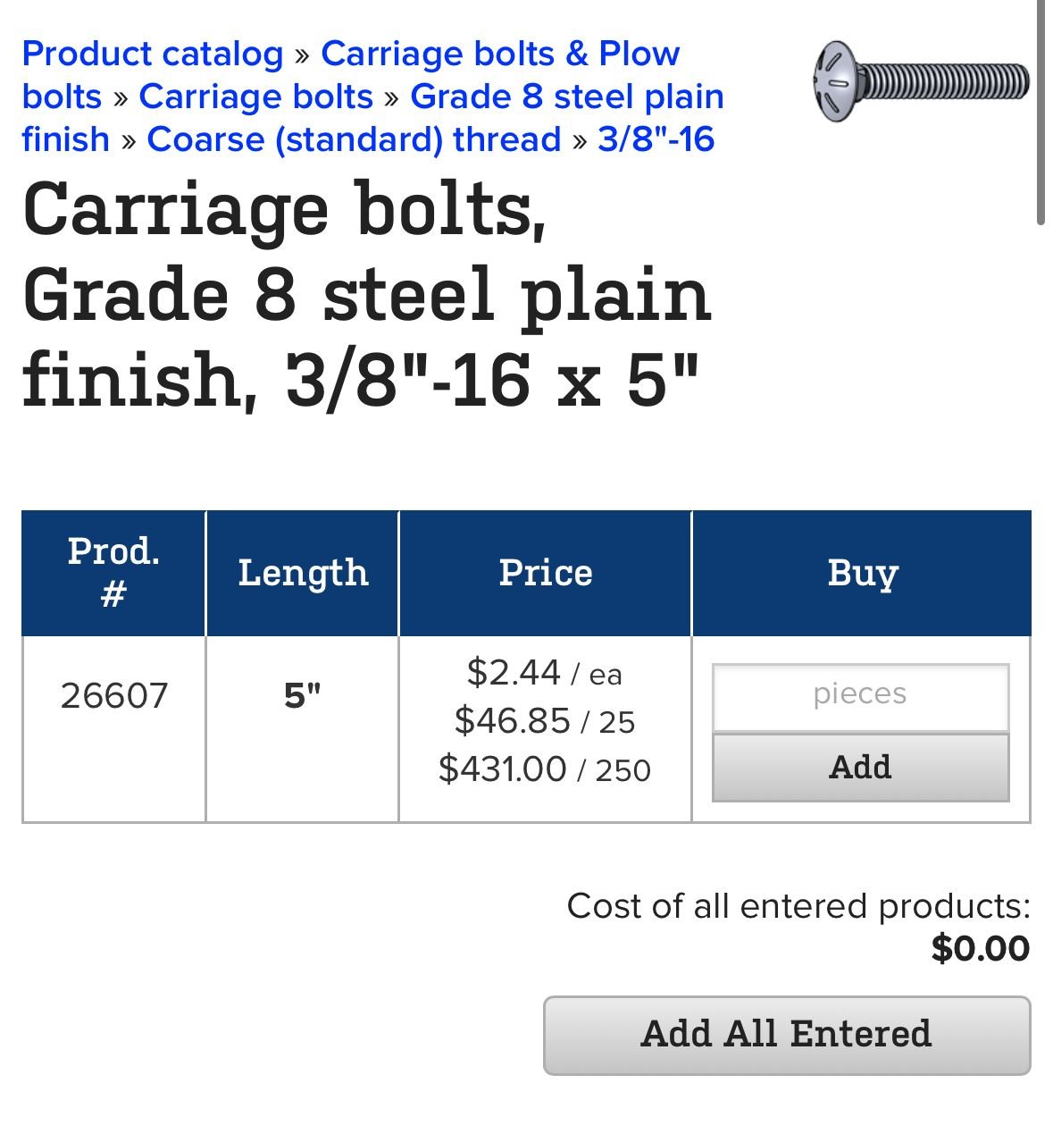

Bolt Depot. The factory size is 4 1/2”, but I added half an inch for the bracket.
With 255/50r17s in the front I notice it “polished” the frame at full lock. I could limit the steering, but I’d like to also not have the sharp edge of a hex headed bolt when I could get a smooth carriage one, peace of mind.
Thanks!
I see Grade 5 at Bolt Depot, but not Grade 8. Still, that might be all you need. If your car will let you insert the bolts from the wheel side, you're all set.
