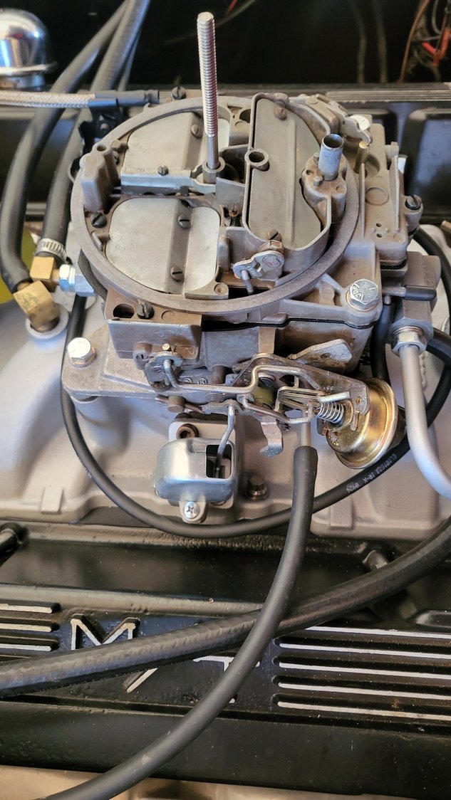

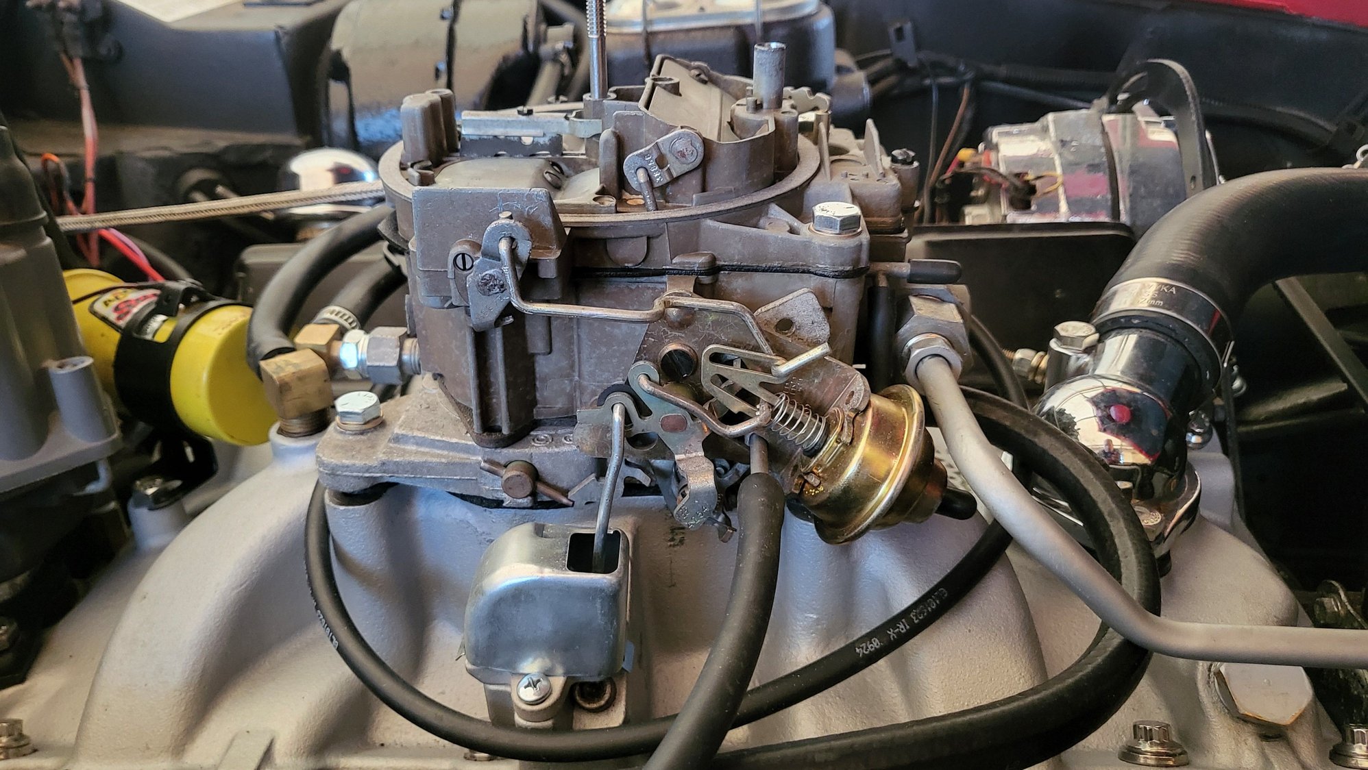

Post pictures of the choke side of the carb and from the top after you set the choke. After his rebuild you should not be having any problems with the carburetor.

See photos below

Here is the choke as I have it set up, this is after one press of the accelerator. I never found any good pictures of the '73 set up so I just pieced it together from what I could find and what looks correct.
I did notice after cranking that the choke plate slightly opens, but I think it did that before putting it on the ramps to change the oil pan.
