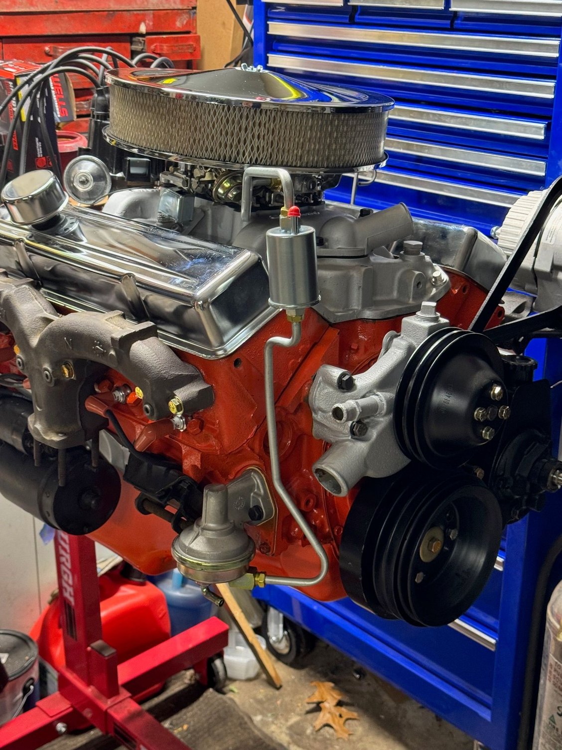

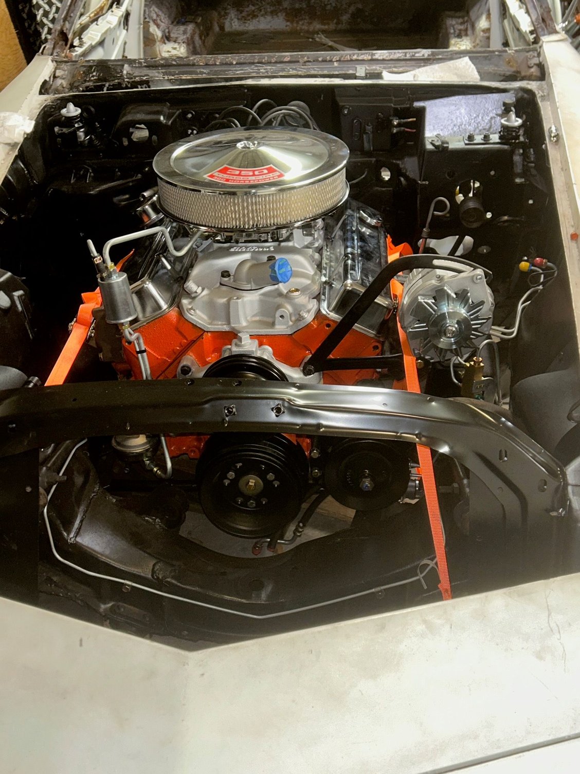

So my son and I are putting back together a complete car. When purchased in September 24 it was nothing but a empty shell on a frame. The previous owner had the engine and transmission rebuilt and lots and lots of parts. The car is a base 1969 convertible automatic numbers matching with great bones. We started the process cleaning, painting, wiring and plumbing everything. When the pervious owner and buddies (bubba) took apart the car they used wire cutters on everything and lost a bunch of parts. By the way when a seller says everything is there, It's not. I have a ton of welding to do on the windshield frame, I'm going to wait till it's a little warmer. Hopefully soon.
We are real close to firing the engine and letting it break in. With new power steering pump and system installed including the ram and a transmission that was stored empty along with a new fuel system. How does one keep an eye on the timing, tranny fluid level, power steering level, coolant, oil pressure and temperature upon the first start. I have never encountered so many systems being empty before. The tranny I filled the convertor, and filled the pan, power steering system is all new I can only fill the reservoir and wait till the pump turns to to purge the air and refill. Coolant is no problem as is fuel and oil. All while adjusting the timing.
I'm a little overwhelmed by what needs to happen when I start this thing. All the systems need checking and filling. I want to run it for at least 20 min to break in the cam. Any advise would be greatly appreciated,
