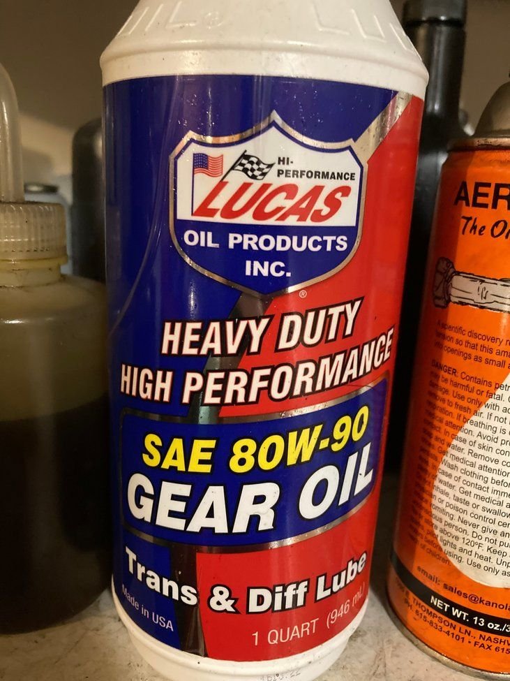

used synthetic and gl4.. both were poor for me.. went with this lucas in my 79 t-10 after rebuild..
in addition to advice..
- check bolts for tightness
- check clutch adjustment
