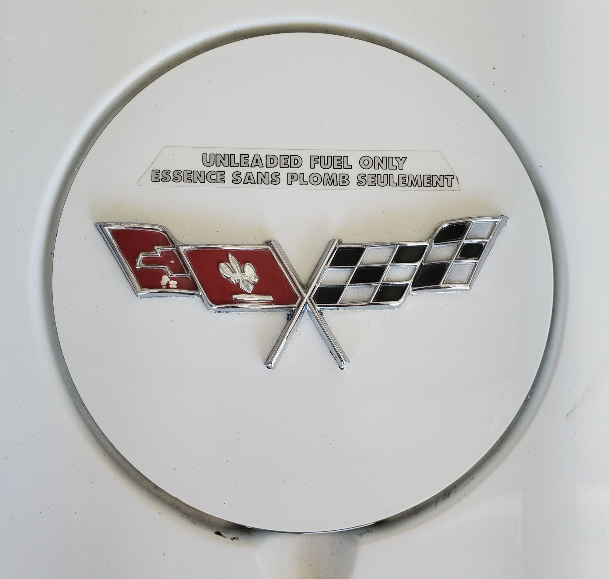

Don't forget one of these!
Unleaded Fuel Label
To 1980 Z49 Option
