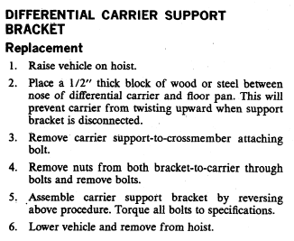

I Have a '77 350 4 speed and will be installing the drive shaft that has just had the ujoints replaced as well as being balanced. Getting the yoke into the Trans is a no brainer. Installing the rear u joint looks to be difficult at best. The u joint is wrapped with clear plastic to keep the bearing caps on so it makes sense to not remove the plastic wrap until I get it close to the differential front flange. My Car is on Jack Stands so if I remove the Differential Front mounting bracket to get more room will I have major issues getting it back in place? I do remember taking the ujoints off ,was a real pain but putting it back in looks to be even more so.
I just want to avoid making a difficult assembly even harder. Of course the rear wheel will have to come off and maybe the exhaust pipe, hopefully not.

Here you go. Found this one day looking at u-joint replacement. Come in from behind with an extension.

FYI. Don't learn the hard way (like I did)!
