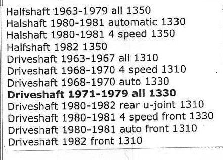

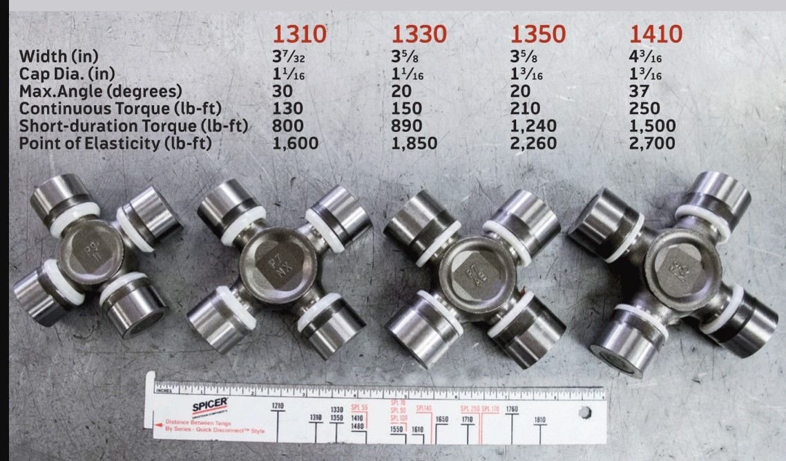

This should help.
Some driveshafts have 1310s. Sounds like yours does.
Make sure you check both ends.
Solid Spicers, no grease fittings, are way stronger than all others.

Awesome! You're absolutely correct based on the size I have. At least I know what to look for now.
Thanks so much for your help!

Default Does this help?

Yep, thank you!
