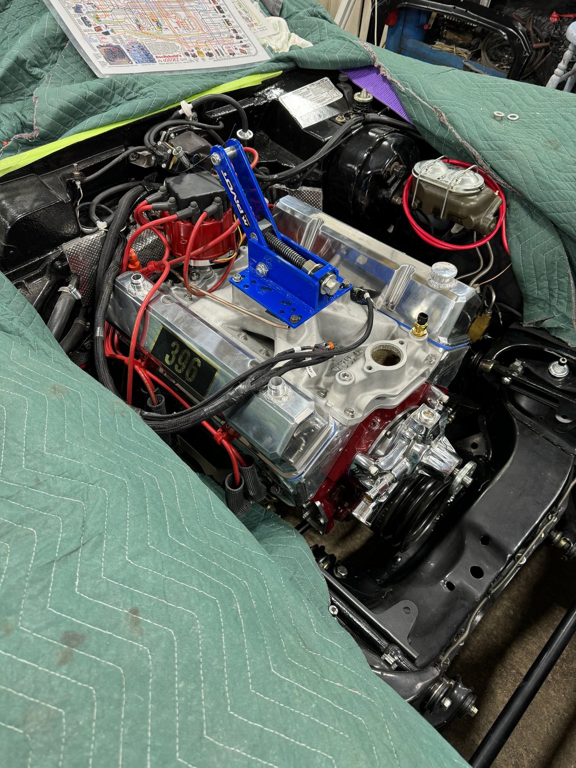

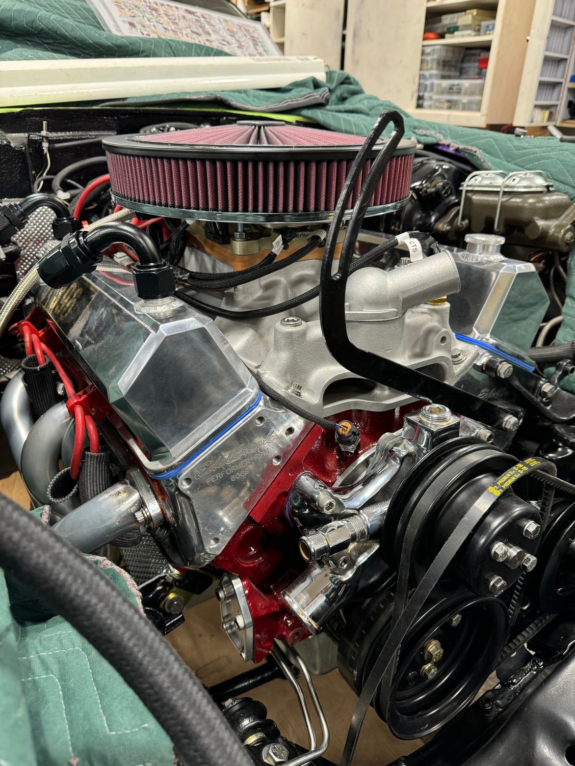

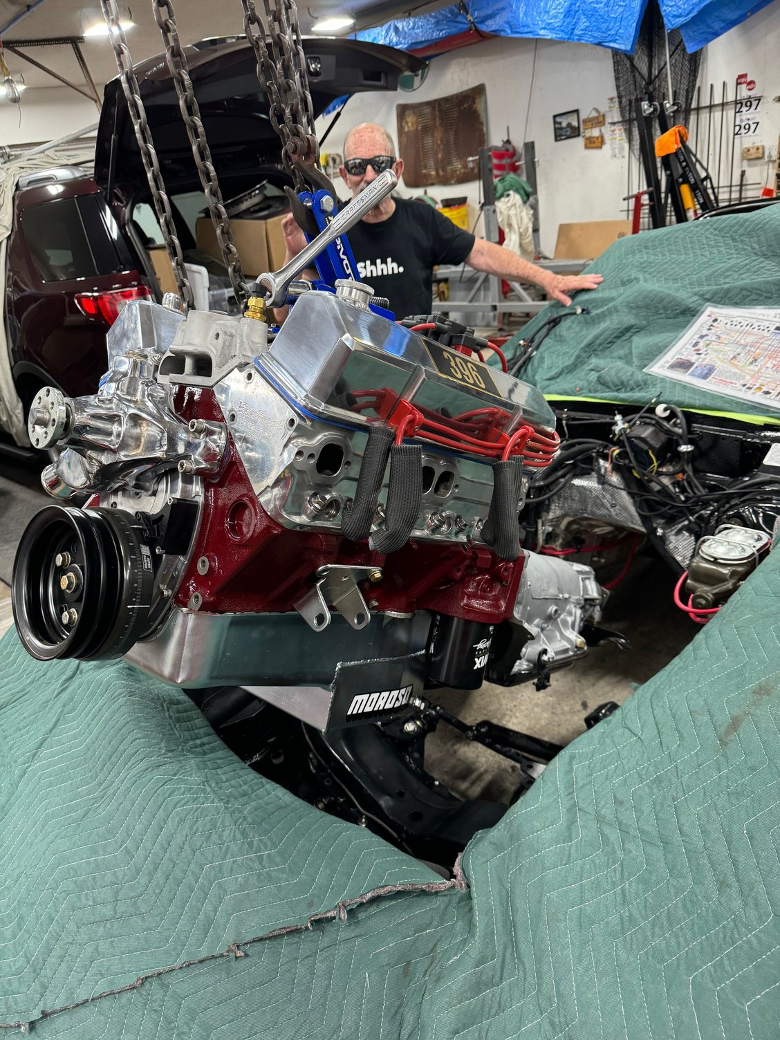

350 block with Scat Stroker Kit in a ‘73. 395.4 cubic inches. 525 HP with FiTech.
