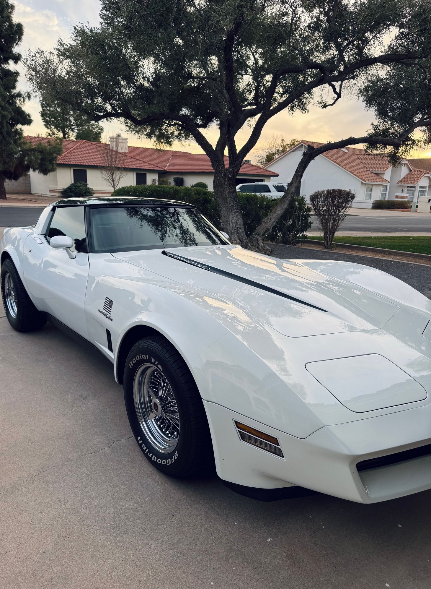

I just recently bought a 1982 Crossfire that came with a 383 stroker crate engine. I was wanting to maximize the power of the engine so I’m looking for some guidance on anyone who has redone their C3 with a similar build!

Welcome to the forum, beautiful car!
If you have no information on the engine specs I would check the ignition timing. It appears to have a lot of aftermarket ignition components as well as port fuel injection. The other thing that engine needs is come colder air. C3s are notorious for high engine bay heat which can significantly reduce engine performance.

We would need to know considerably more about your build first. So far we know the cubic inch displacement and what we can see in one tiny pic. Which isn't much.

Is that a chrome fan???? radical, 100+ H.P.
Nice job!

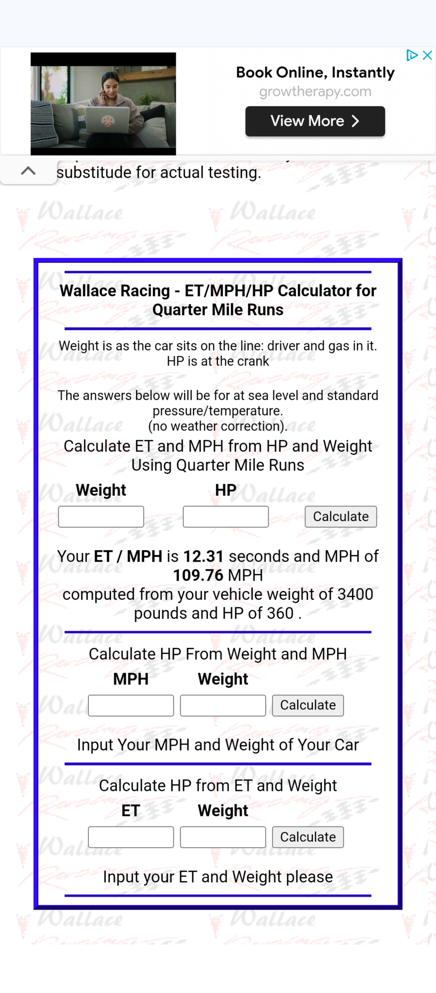

Claimed 450hp is a decent amount of shove, if you feel its insufficient first thing I would do is get the car on a dyno and find out what the rear wheel horse power is. Then I would be giving thought as to what differential it has, did you have any information as to what drivetrain you have? Transmission/differential/trailing arms? Others will correct me if I'm wrong but I believe that the '82 diff isn't the strongest so if you are going to apply more power often you may run into issues with the drivetrain.

I looked this up about a week ago but I can’t say I really understand what all the specs mean haha.
Well here the most important spec. Congratulations!
BTW I took 20% off the HP rating for in chassis losses.
