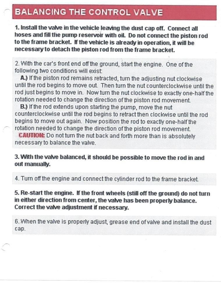

Default Here's how to adjust the PSCV:

Yes I made the adjustments yesterday and it is perfected, thank you, it was a little trial and error, but i got it done,

Isn't it a wonderful feeling when you fix the issue without having to pay someone? With the help of Melwiff, HeadsU.P. and Peterbuilt you were given great advice on centering the power steering system. It is awesome that the issue was a "less complicated repair" versus having to tear apart the steering system looking for the problem.
