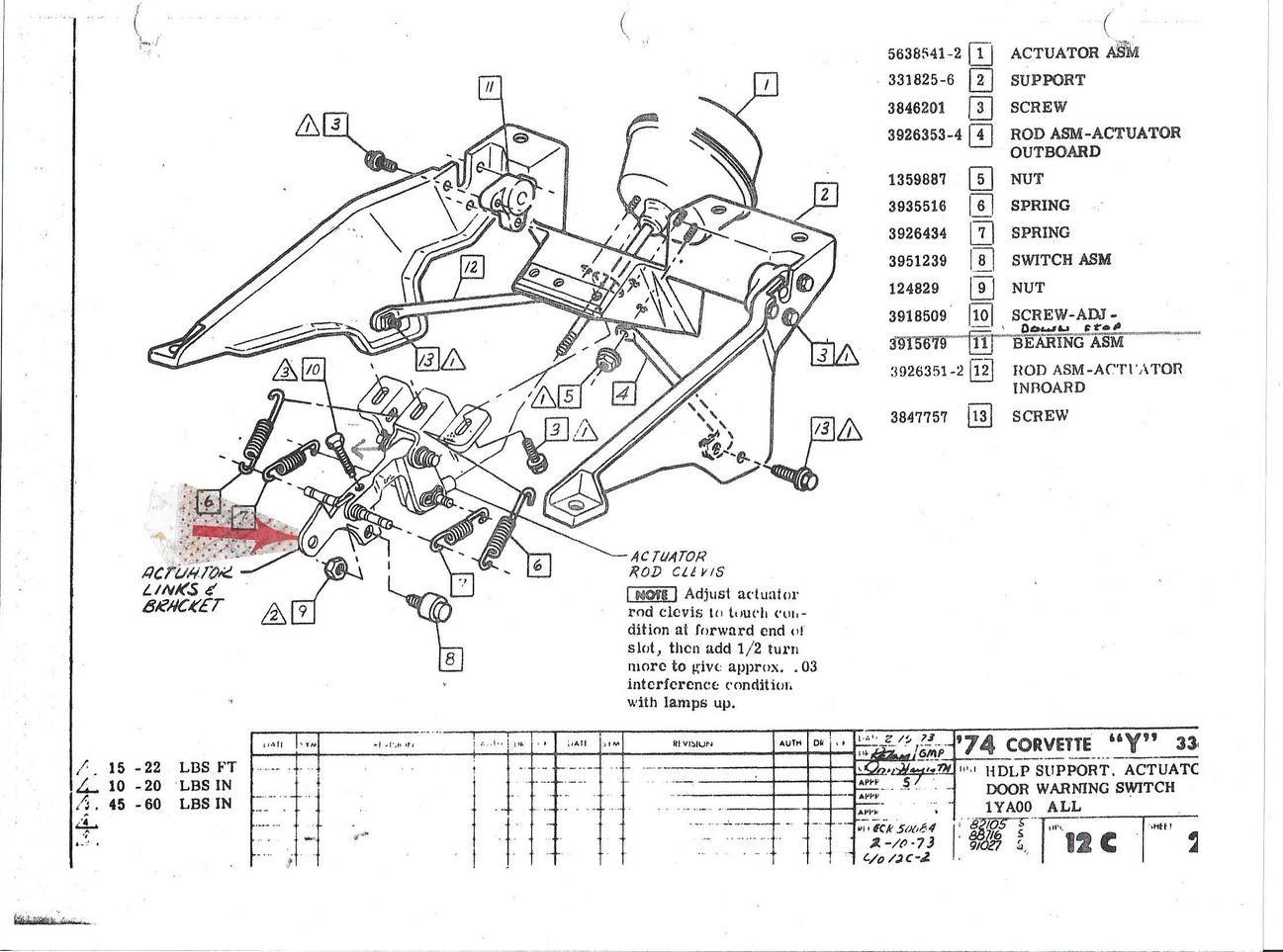

I have a 72 Base Coupe. I have the center cluster removed. WIth the battery connected, the center console "Headlamp" bulb illuminates when the headlights are on,
With the headlights OFF, the HEADLIGHT bulb will be OFF.
When you pull the headlight switch OUT, that bulb will light up for a few seconds until the headlights are fully UP, and then the bulb should go OUT.
There is a switch on the headlight assembly, and it may be out of adjustment.
See #8 on the AIM to locate the switch.
Never mind the arrow.

Originally Posted by dnardozzi@yahoo.com
I am testing the lights with the engine not running, so the headlights do not raise up. I imagine that is why the light stays on. If that is not the case, I will look at the adjustment you mentioned above. I will not know until I can fire the engine. Thanks for catching that.
The RED arrow is the place to push UP or pull DOWN the headlights when you have no vacuum.
