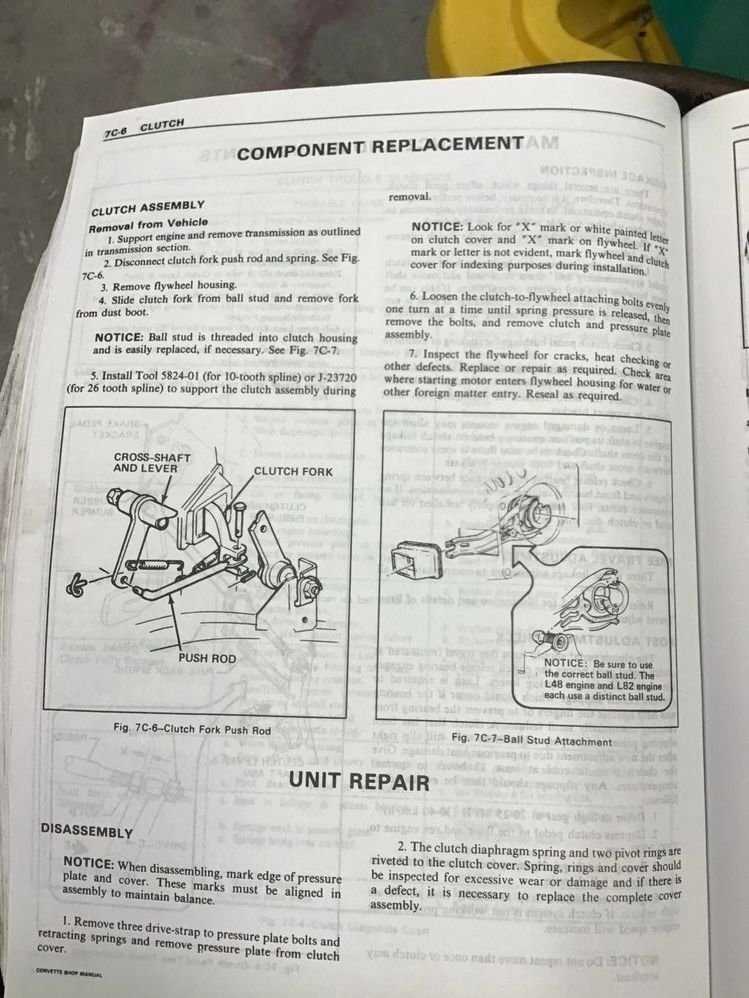

Throw out bearings are more inclined to "rattle" when free-wheeling when they are failing. Pressing the pedal is when a bad throw-out bearing stoops making noise. A clicking noise you can hear when the car isn't running and you depress the pedal probably isn't the throw out bearing at all. The fork attachment to the bell housing, the z-rod and other pieces of the linkage that connects your foot pedal to the end of the fork pushing that throw out bearing into the fingers on your pressure plate all are suspects I'd be more inclined to look at to explain a clicking noise as you describe it. Even the spring that ensures retention of the adjustment bar between the end if the pedal linkage and the clutch forks are potential suspects here.
A light cliking noise is far from unusual and rarely turns out to be an actual problem or indication of impeding clutch failure.
We don't see many standard shift transmissions anymore but over the last 30 years virtually all have hydraulic clutch activation that we've come to think of as totally silent. Old school linkage makes NOISE especially if pivot points haven't been maintained.
By all means if this noise really bothers you. Get the car in the air. Make sure you're absolutely SAFE when the clutch gets depressed by a buddy and get under there and figure out where the "click" is happening. I'm betting it's in the linkage and no big deal at all.
On the flip side. If for some reason I've got this one wrong and you do actually have funky throw out bearing making a "click" that I've never heard before. You will have to pull the transmission to get a new one in there and for me I'd be inclined to swap out the disc and pressure plate while I had it apart or at the very least pull it apart to inspect it just to be sure it's got enough life left in it to justify the extra effort of doing this a second time out in a distant future rather than anytime soon.

The first thing i would do is check for looseness in z bar, clutch cross shaft, and all other linkages.
that bar can unscrew. Include pedal assembly. Poke a camera at fork as mentioned.
