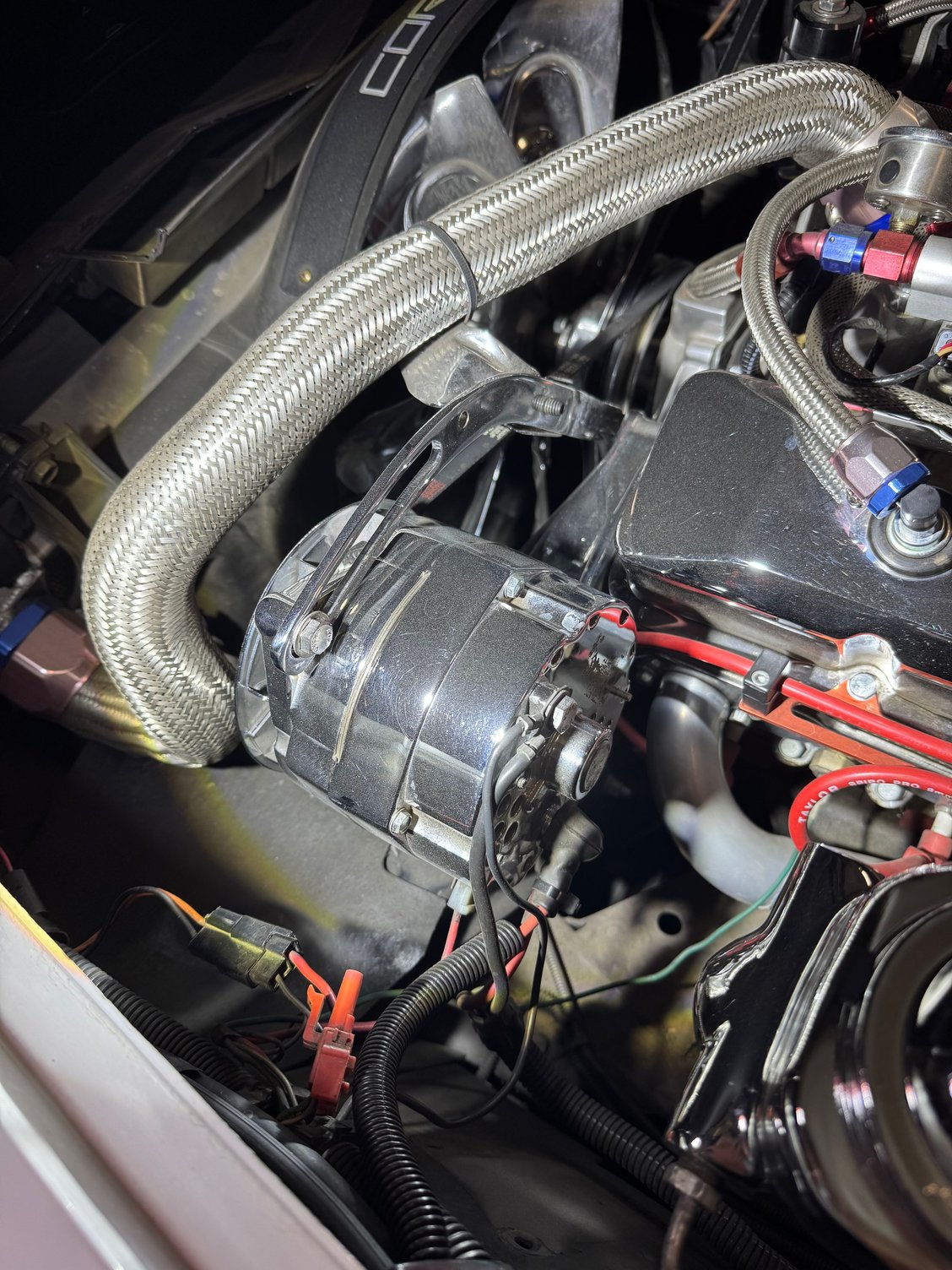

Tell us about your car to check how the charging system was set up on that thing. Take some close up pics of the alternator and it's connections and see if there is any info stamped/written/etched on it.

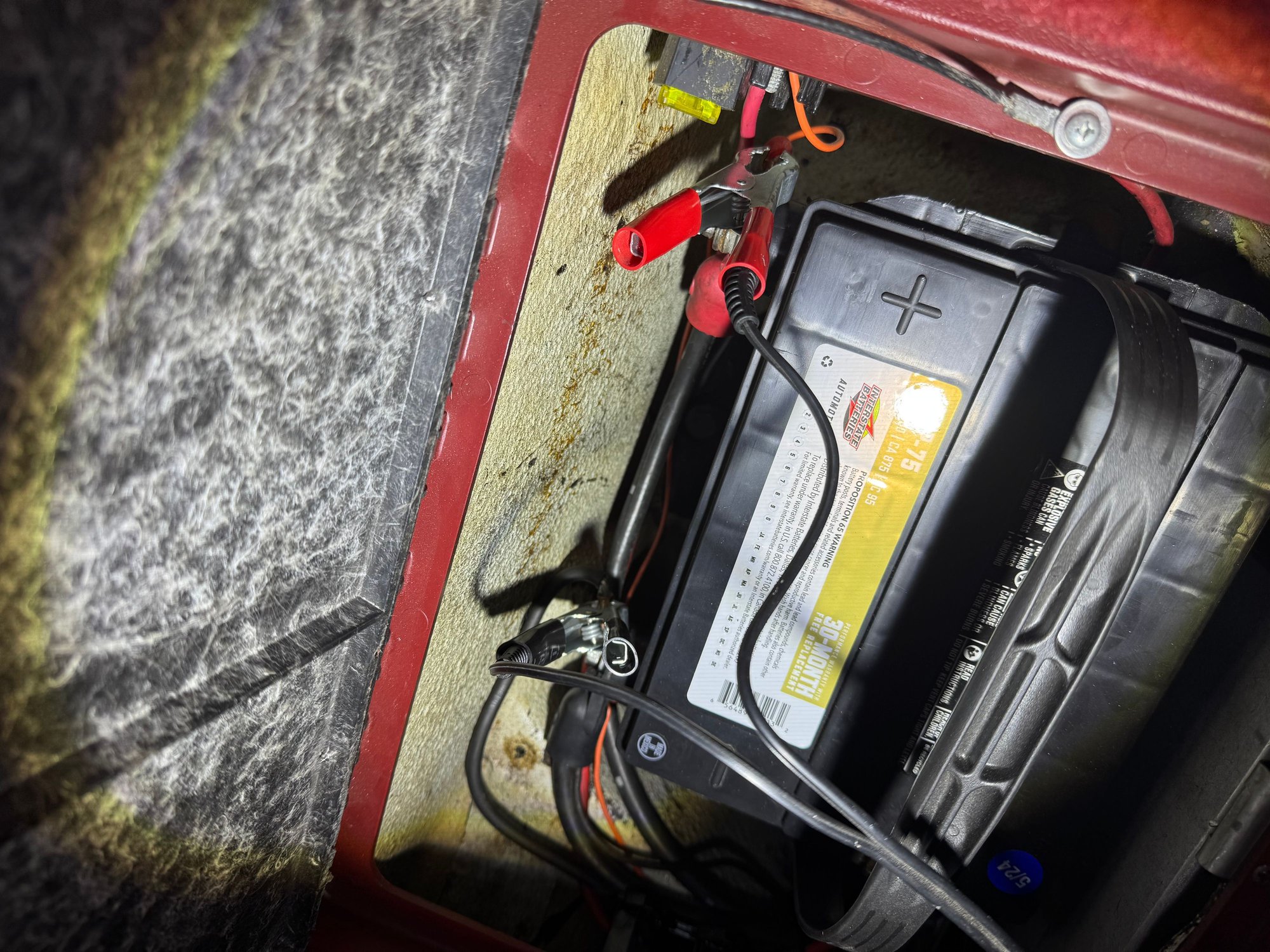

Didn’t start when hooked up to jump. I believe I need to remove this plate to access the alternator numbers

Alternator looks like it has the generic 12si connector on the side so probably stock to an 82. No need to take anything else apart. We can improve on that once we figure what's going on with the engine.
