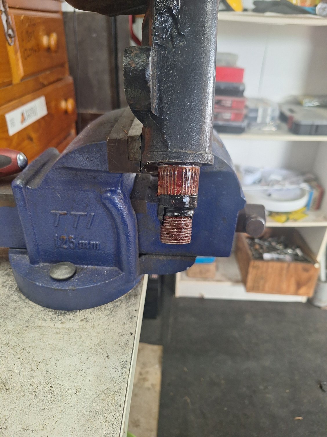

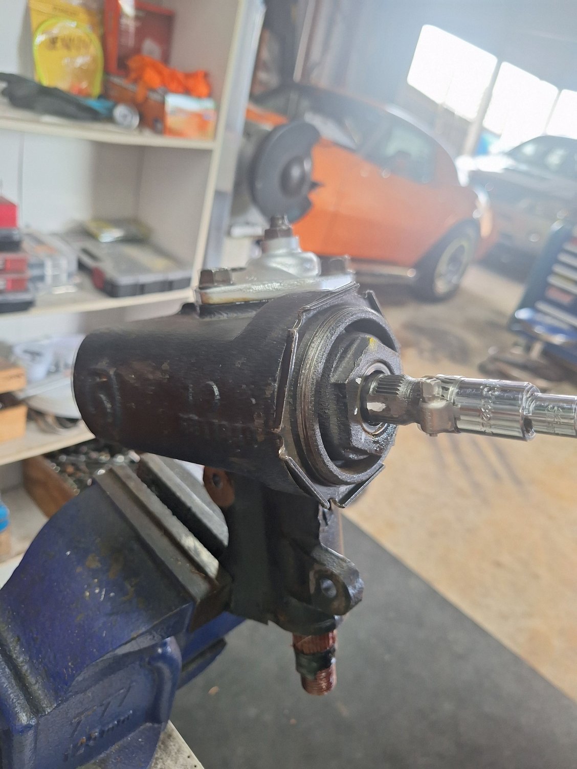

I have searched but not found the reason / fix for my 74 steering box rebuild issue. It's done and all good on tq wrench in ftpnds ect. My problem is I have the tight spot centred but it has the D flat facing 9 oclock not 12 o'clock.
does this mean I have to undo pitman shaft cover & lift pitman arm to turn my d flat to 12 o'clock position then drop the pitman arm back in ? The yellow dot is 12 o'clock and the 3 white dots are the tight spot. Middle being dead centre of tight spot. So it seems it's 90 deg out lol. Thanks in advance for a correction to stop my headache haha cheers Rod

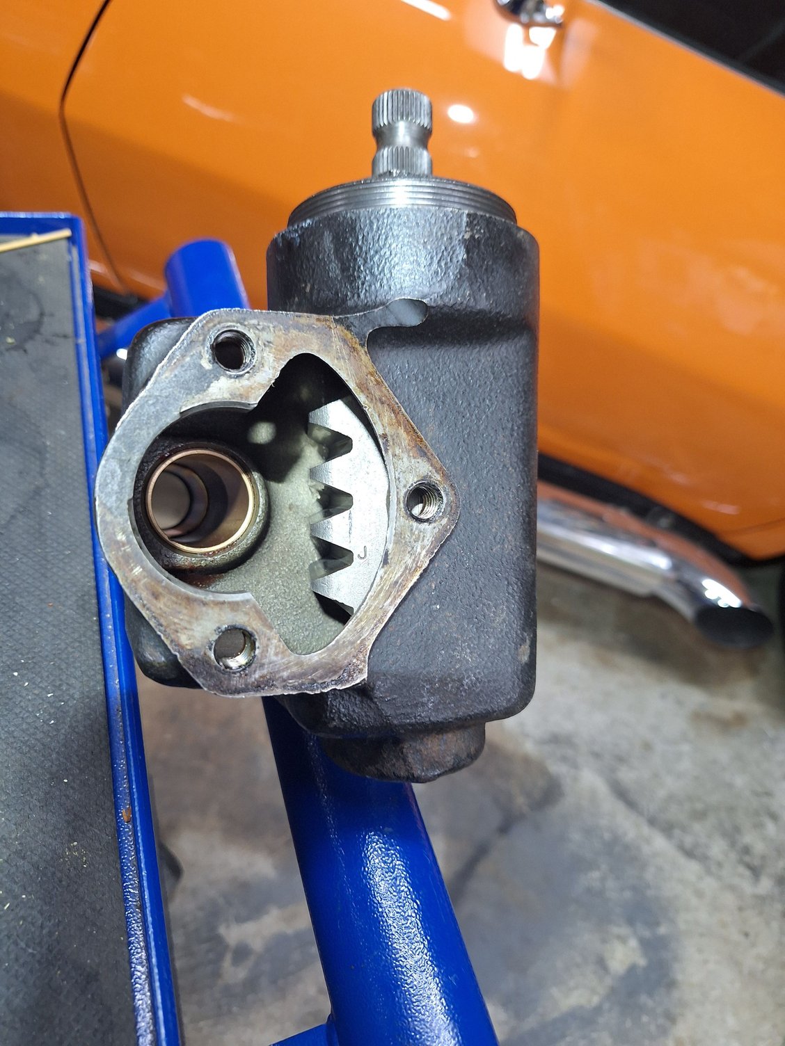

Yeah cheers I obviously missed something. P took pitman shaft out and am trying different teeth but it won't. Only seems to go together like that.

Well closure on the case anyhoo some dik has fitted a different worm from some other chev box. It works but can never get d flat at 12 o'clock and high spot at 12 o'clock. Bubba I hate you haha. Thanks to Gary for his replying to my personal message asking for help.
On centre with D flat at 6 oclock 🤣😂
