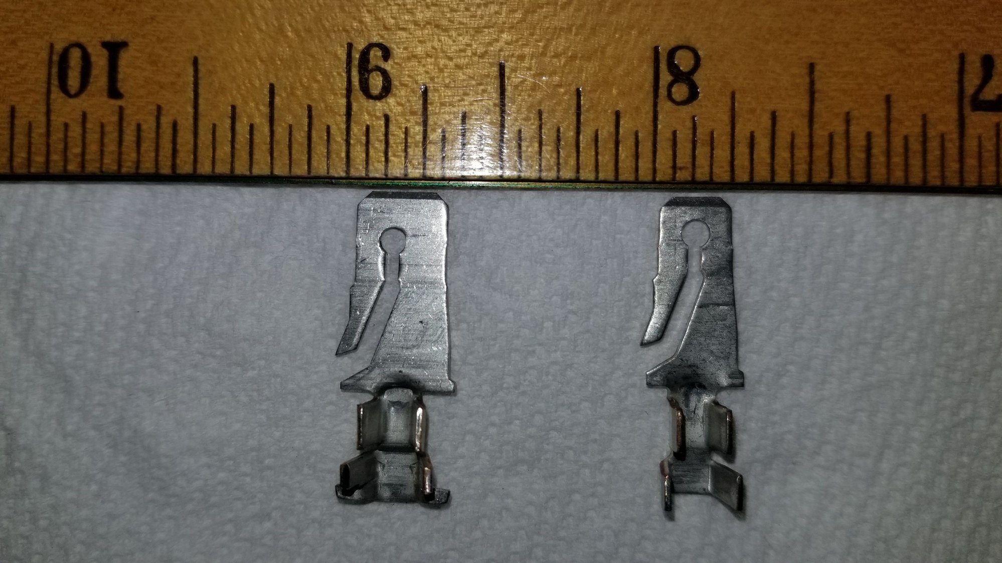

As I was putting the fuse box together at the firewall, somehow I managed to break one of the connectors on the firewall side. attached is a photo of it. It is a 78 vette , but has a 79-82 ? (not sure which year) wiring harness with blade fuses. Hopefully someone can guide me to the correct place to get a new one.

That is a Male terminal.
They come in series 56 = 1/4" or series 59 = 5/16"
I'm guessing that is most likely a series 56.
For wire gauge sizes 16-14 that Male terminal is Delphi/Packard part # 2971962
For wire gauge sizes 12-10 Delphi/Packard part number # 2971859
Type either part number into a e-bay search, most likely you will need to purchase multiples...

That is it exactly ! Thank you so much for responding .
I will search this evening and get some on order .

I went to my local NAPA store and got one for about a buck. and two trips ( 1 to order/one to pick up ).
Thanks again for the part #.
