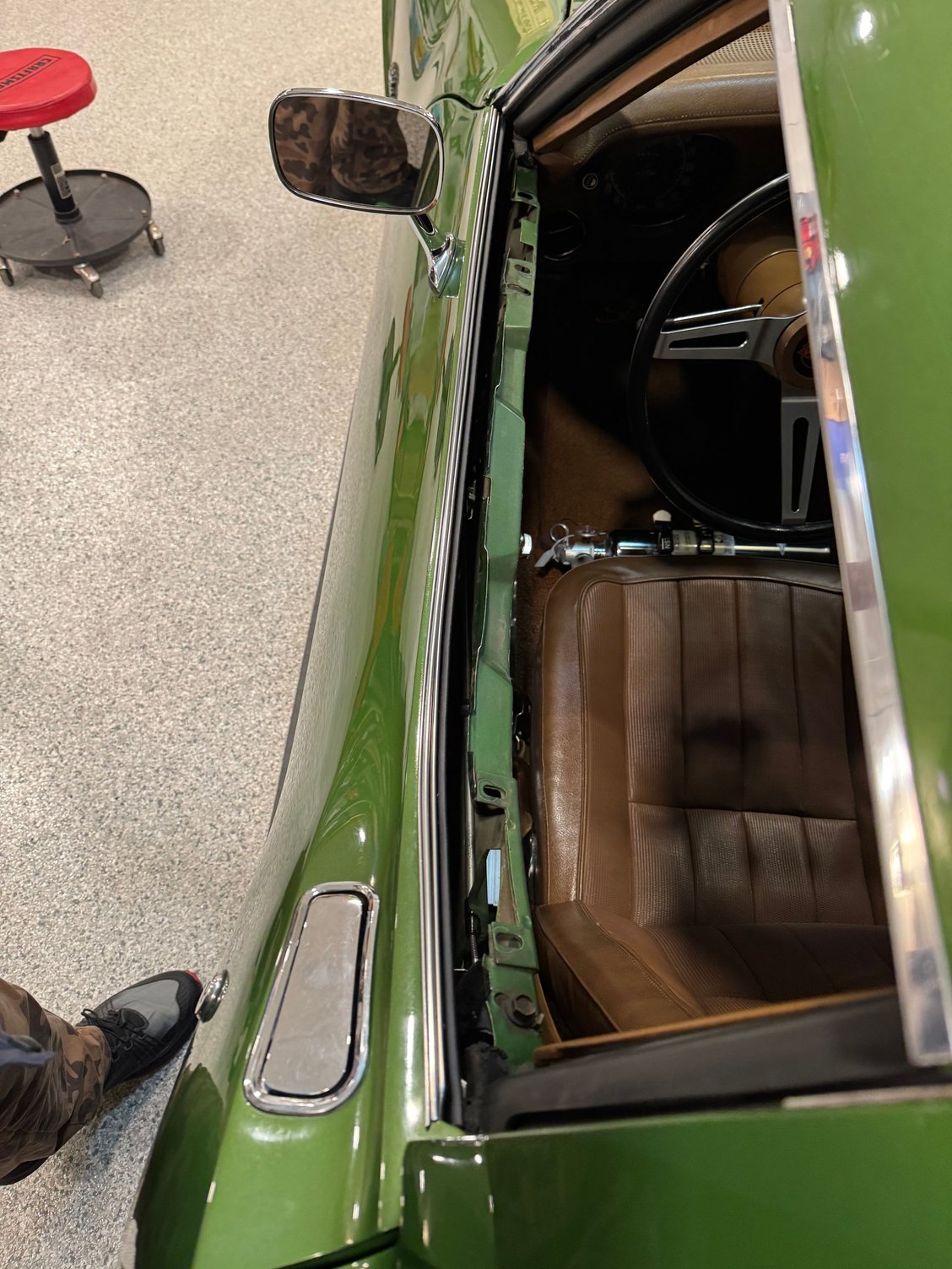

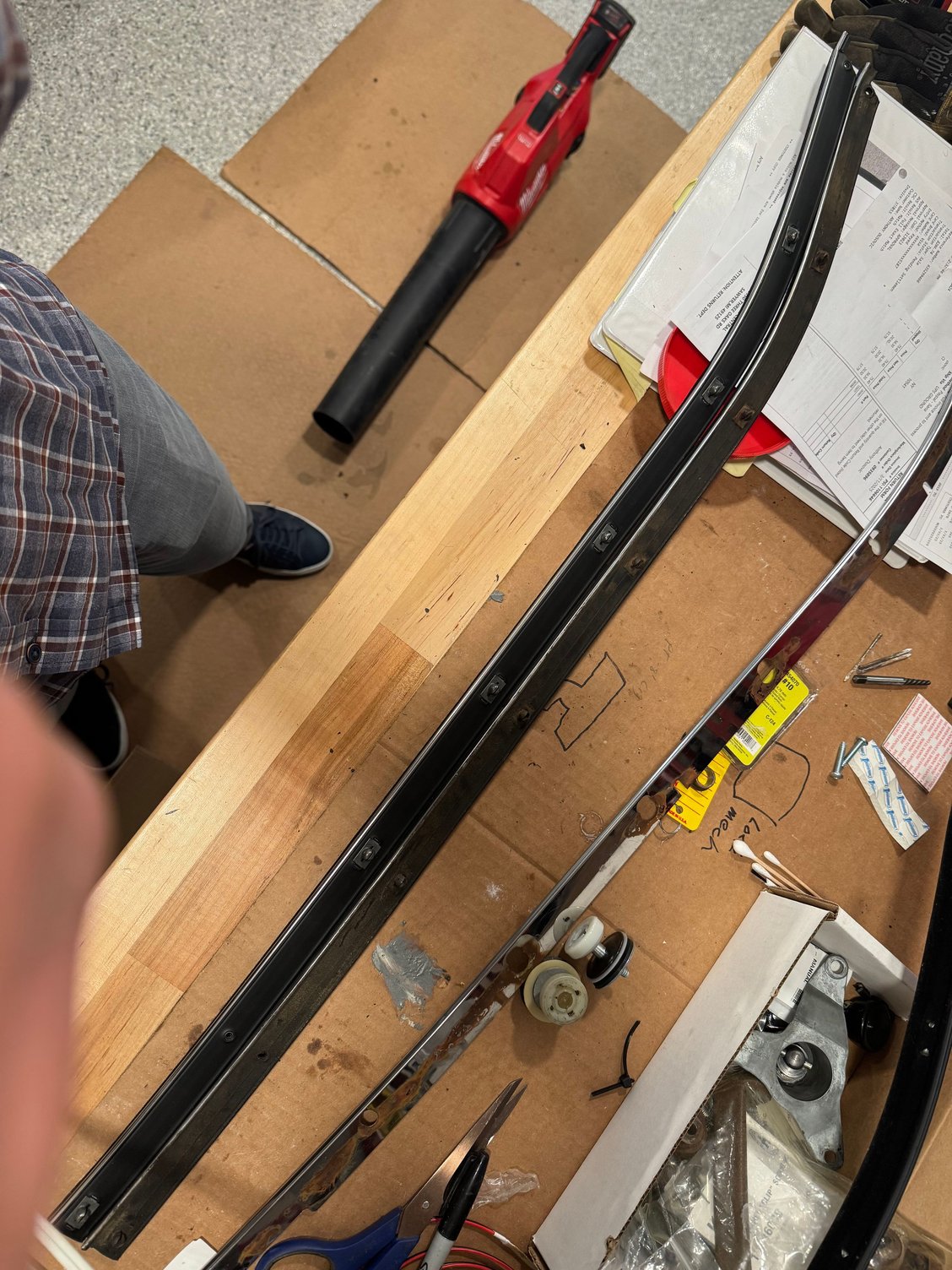

Anyone else have a problem with replacement window seals that don’t line up with the holes in the door?
I tried squeezing them in a bit and still struggling.
I tried 2 different vendors and struggled with both.
Any suggestions?

Oh, and what to do about it. Very, very carefully rebend them to fit. Then redrill to fit. No one will have them that won't require re-work.

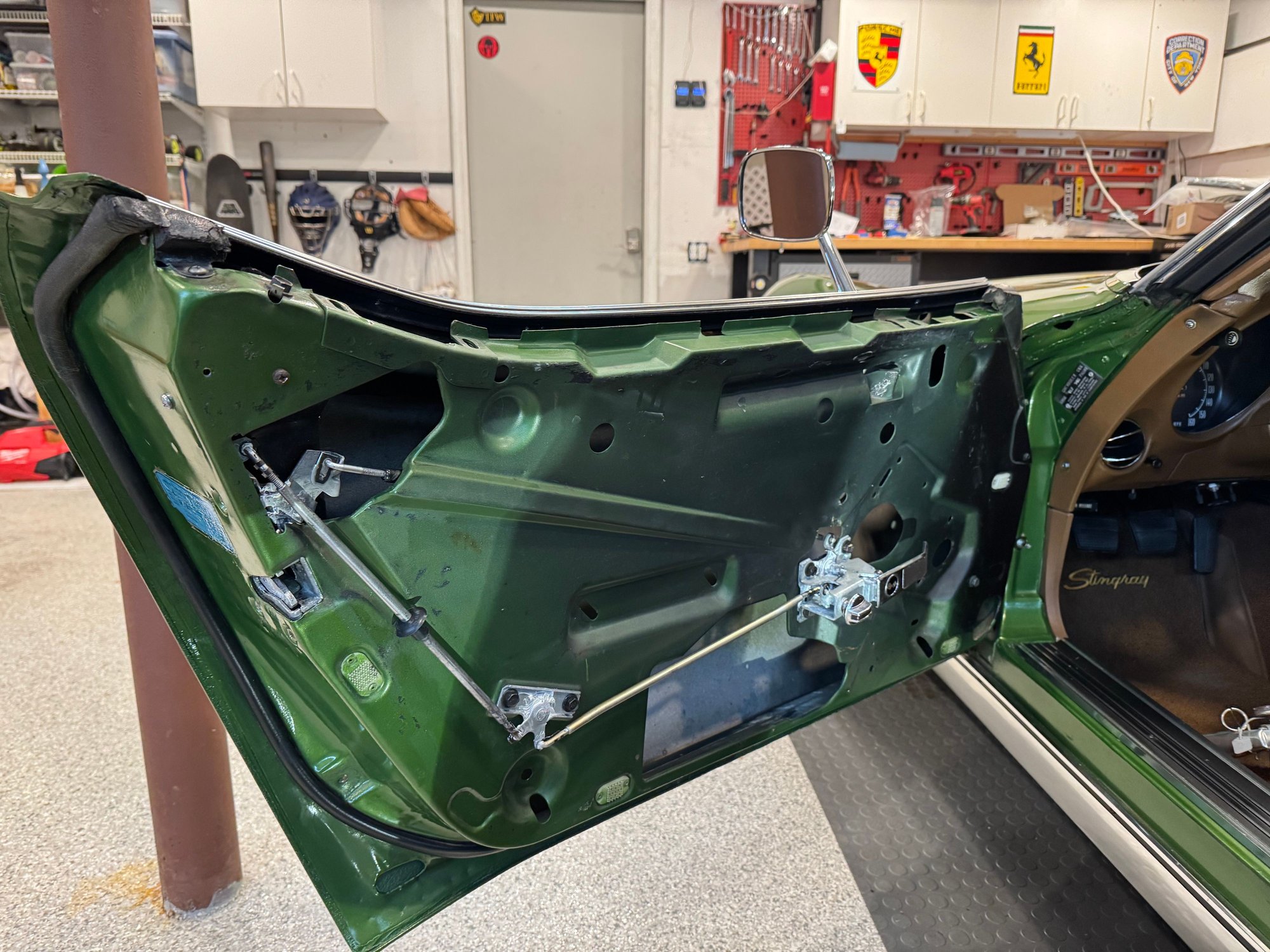

This happened to me on my 73. I used a Dremel with a small bit to drill new holes that would match the restoration wipes. This job requires that you go slow and be aware that letting the drill go deep can PIERCE the outside of your door. Like others have said, the restoration parts don’t always fit, and it seems that every Corvette Seller buys their parts from the same Chinese Manufacturer.

Got it done. I first opened up the holes in the SS trim so the strips could move around and little bit. I squeezed the snaps horizontally and opened up the slits as well. After all that I just needed to open one hole in the door, closest to the rear kick up, just a tiny bit. Not as tight looking as the originals but it will have to do.
