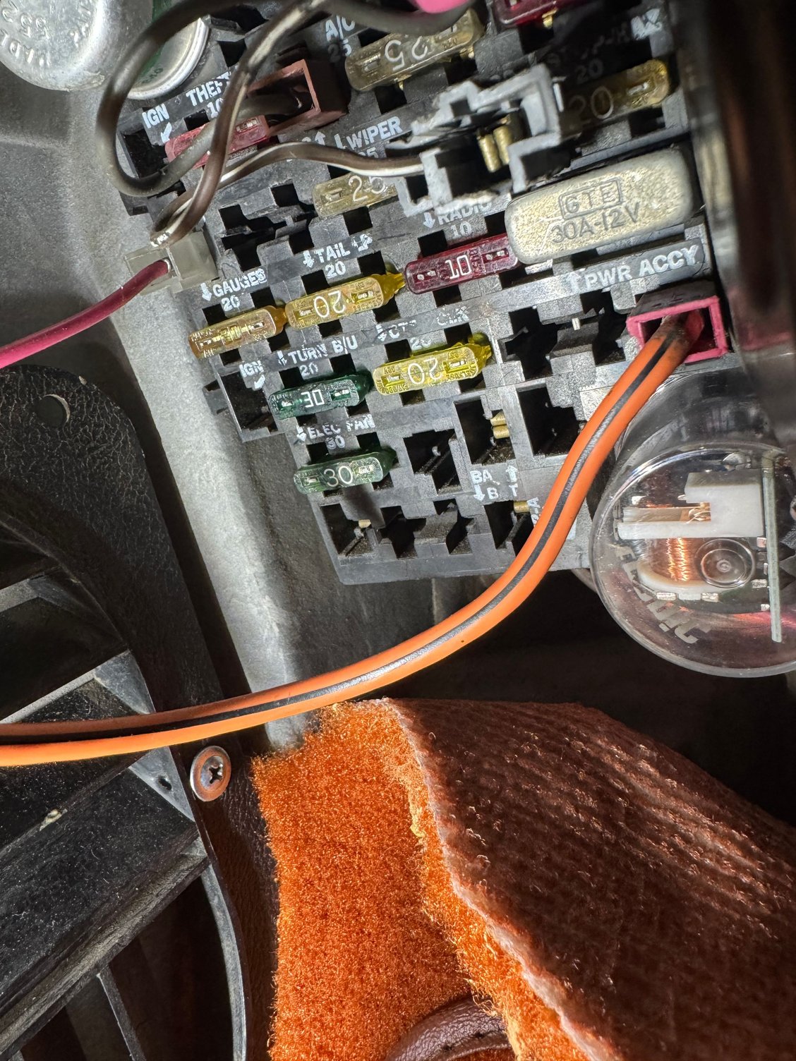

What is the brown/white wire plugged into the acc fuse location , I have struggled to remove it and don’t want to break anything. Trying to get to the tail light fuse ! Any help guys

The grey connector with the Brown/White wire is called a ATO tap connector. There should be a tab on the top side (UP side) that presses in to unlock the connector from the cavity. Press that in and gently pull it out.

What year is the car

Thank you , that’s actually what I needed to hear
