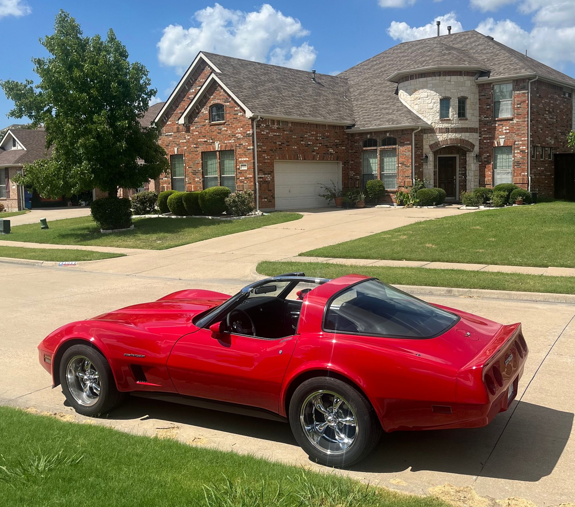

My 82 has the factory gymkhana suspension option. It’s ~ 28.5” to the bottom of the fender on all 4 corners.
I’d like to drop 1” but there’s so little ground clearance already. I have Nitto Invo tires 255/50-17” that actually measure 26.5” versus listed specs of 27.05”. I’ll most likely look for a tire that actually measures a full 27” when the time comes.

I can see your full post in the forum email, but actually I'm the forum, odd error. That suspension has the steel multi-leaf spring in the rear? 27.5 was mentioned a few times in the thread. Folks also said to watch the bump stop clearance and shocks for bottoming out.

Yes the gymkhana suspension has the steel rear leaf spring and higher rate front springs. Not sure if 82s with the gymkhana sit higher than the standard suspension.

Sweet ride. What's your thoughts on the HD suspension vs standard?
