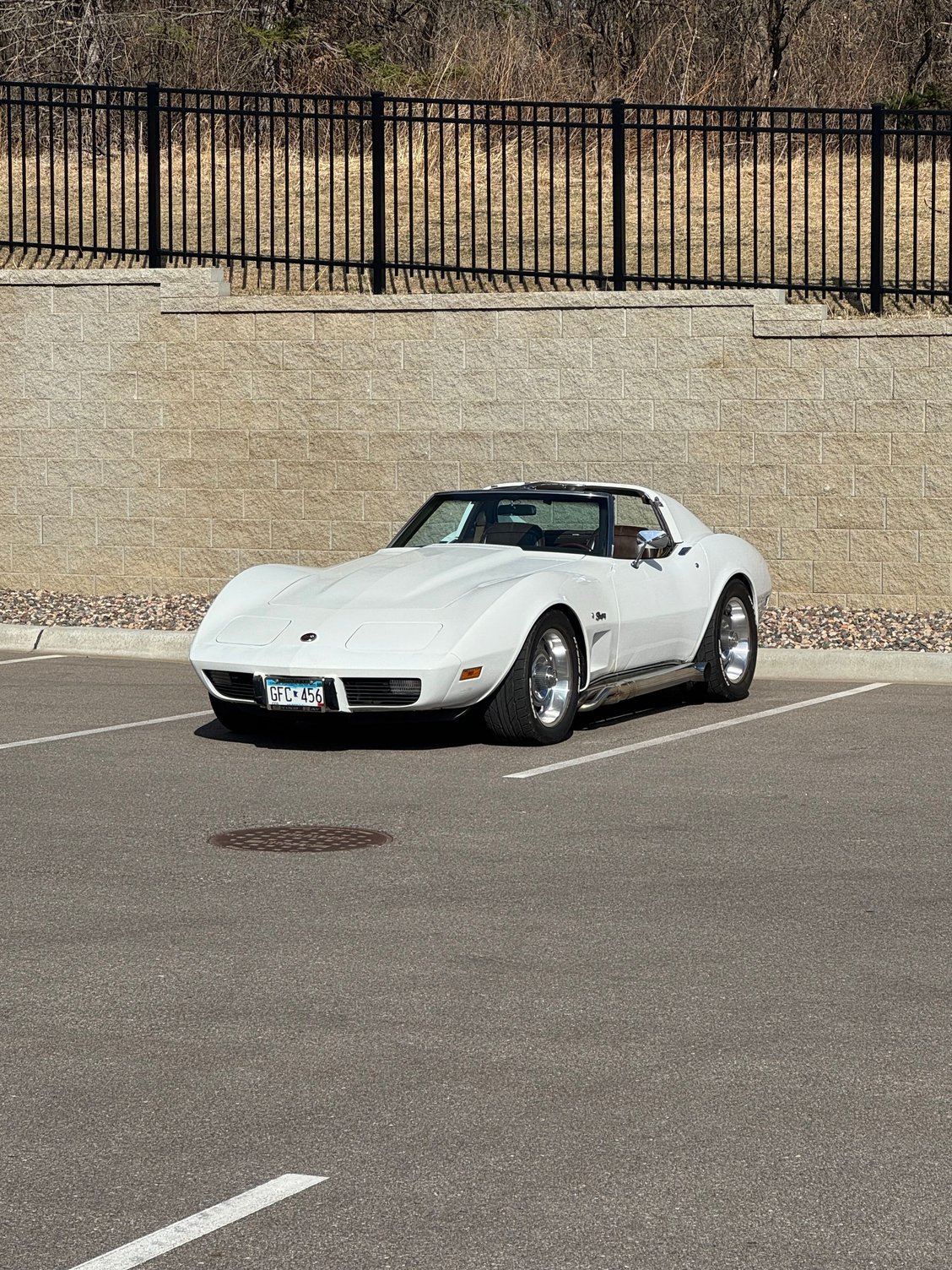

I have a small block car, so it’s not completely the same, but as far as I can tell the design and fitment should be pretty much the same between the two brands.
Both require trimming on the rocker panel and maybe a small bit of the fiberglass underneath, but there’s no reason either system would prevent you from having rocker panels altogether. Probably just lazy people in the pictures, like me when I first put them on.

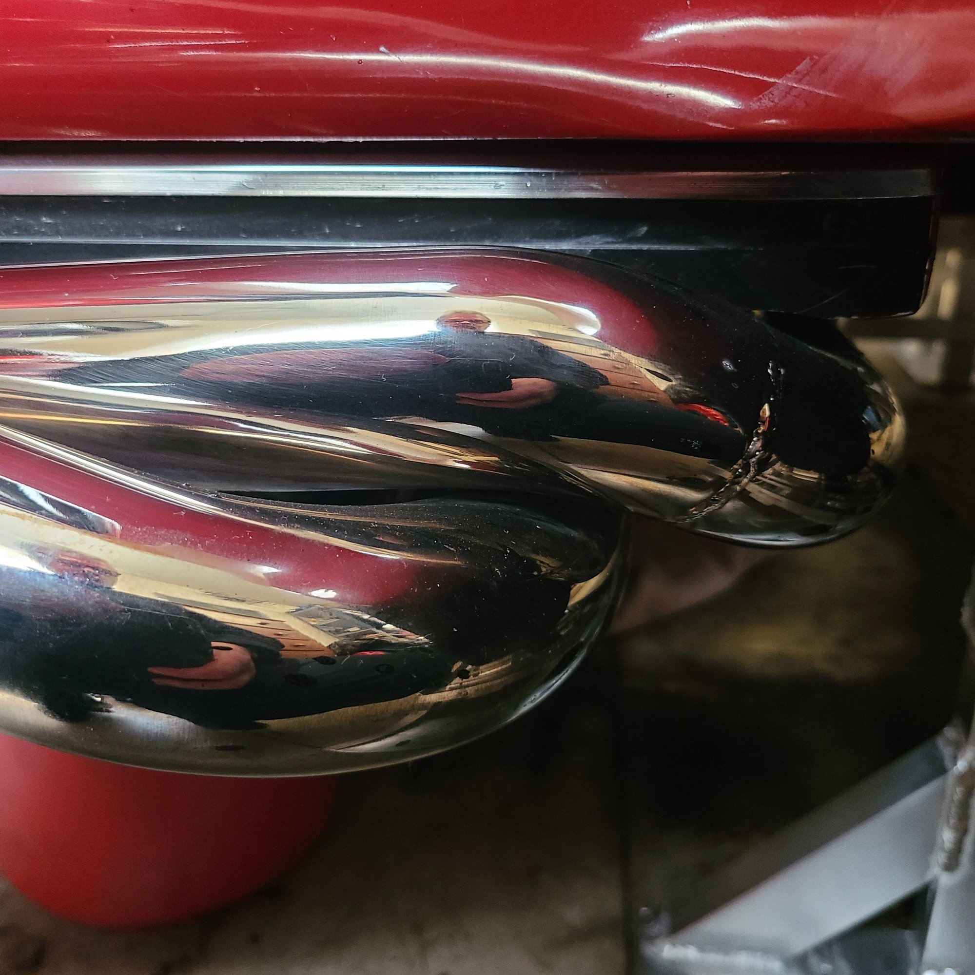

Dougs are thicker gauge steel than Hooker so they should last longer. Lars had a thread about how bad his Hookers fit. I bought Chromed Dougs and used Vettepacks for mufflers. Drivers side had plenty of clearance. Passenger side needed a slight trimming of the rocker panel trim that is not visible once installed.
Hard to tell the rocker panel was modified

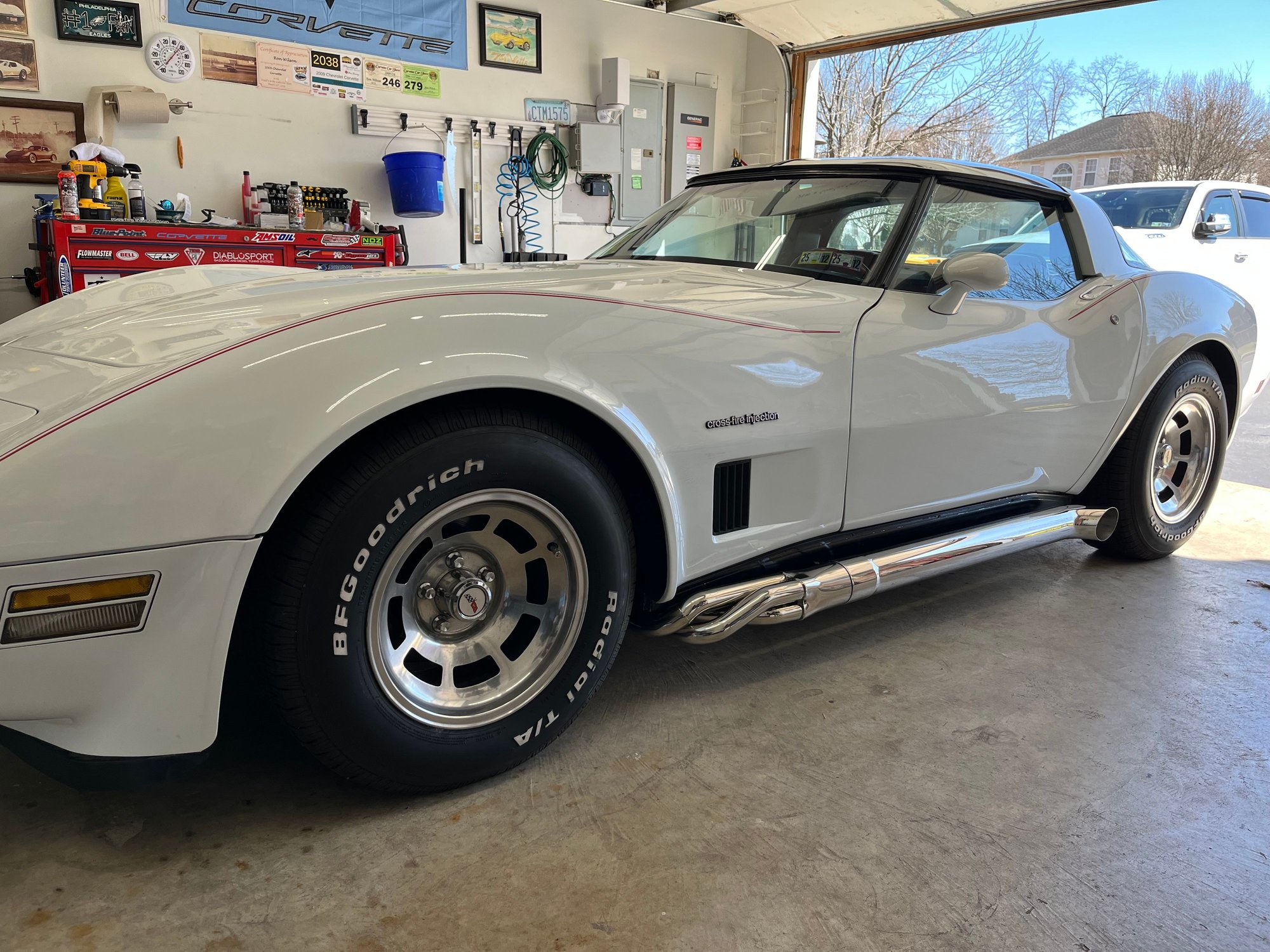

I recently installed a set of Hooker stainless on my 80 and as with anything aftermarket, had to do a little tweaking for them to fit properly.
The directions are general in nature and I did have to trim the rocker covers on both sides.
The thing that ticked me off was that the side pipes came with no mounting hardware. Had to buy that separately. That makes no sense to me.
I used a set of Spiral Turbo Baffles from https://www.spiralturbobaffles.com/ and they fit perfect.
