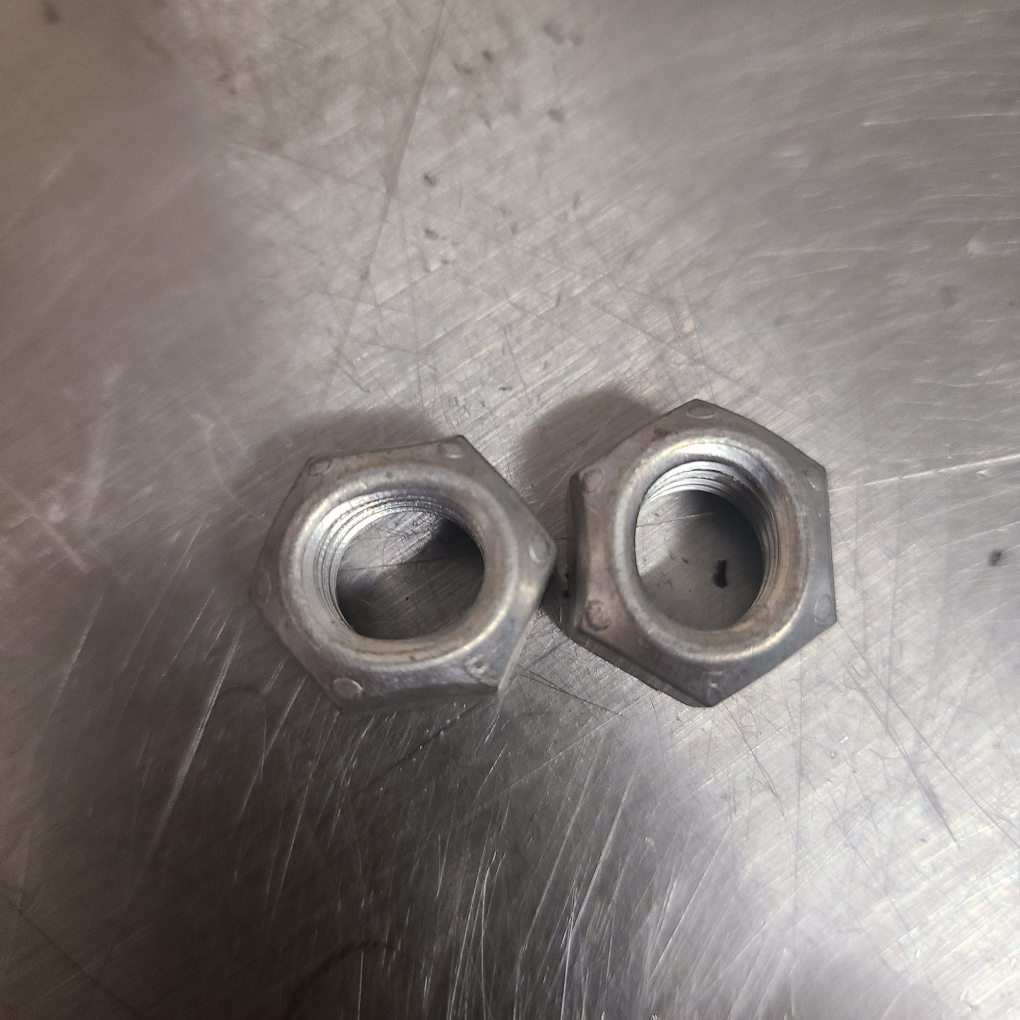

The manifold nuts need to be prevailing torque style if you want them to stay tight. They look crimped from the top. Regular nuts will back off quickly under normal use. Some people like to use brass exhaust manifold nuts and those work well too.
Prevailing torque nuts for exhaust manifolds.  They are deformed to stay tight under high thermal expansion.
It has a new set of studs with long Brass nuts on the Left the studs on the right side are generic with the Nuts you showed and No Grief on the right
