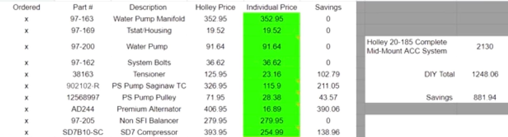

I also recommend Holleys mid mount kit because it fits under the hood and between the control arms but doesn’t require water pump modifications. It is quite expensive though. People have been able to piece them together only buying the parts from Holley that you need to. The rest of the parts are generic GM pieces that can be had for much cheaper.
