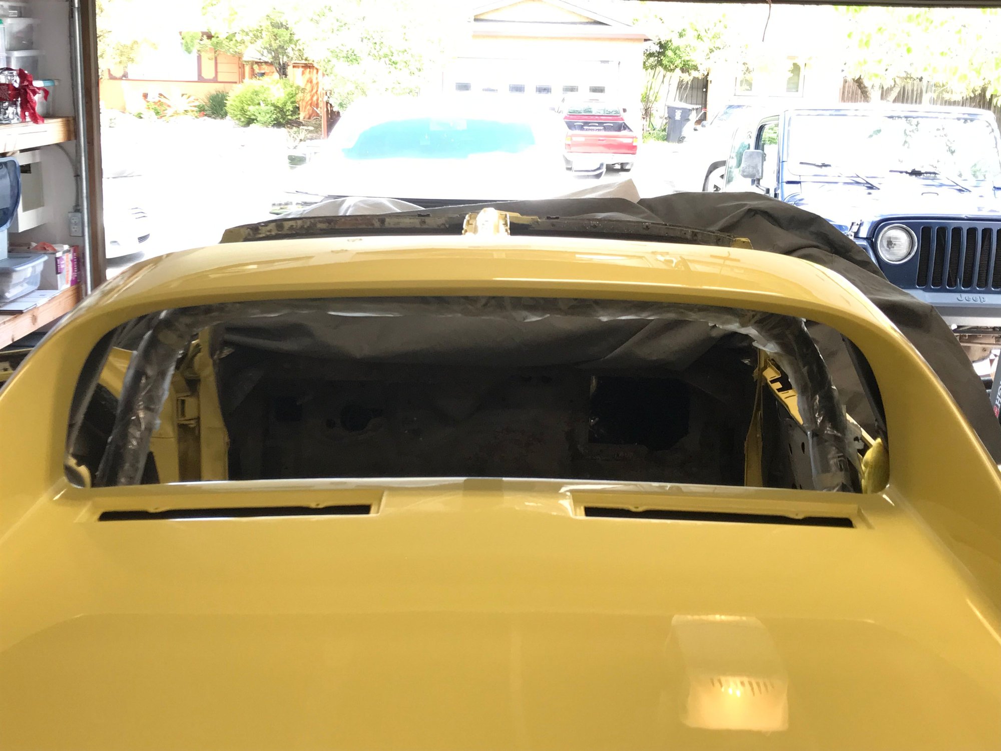

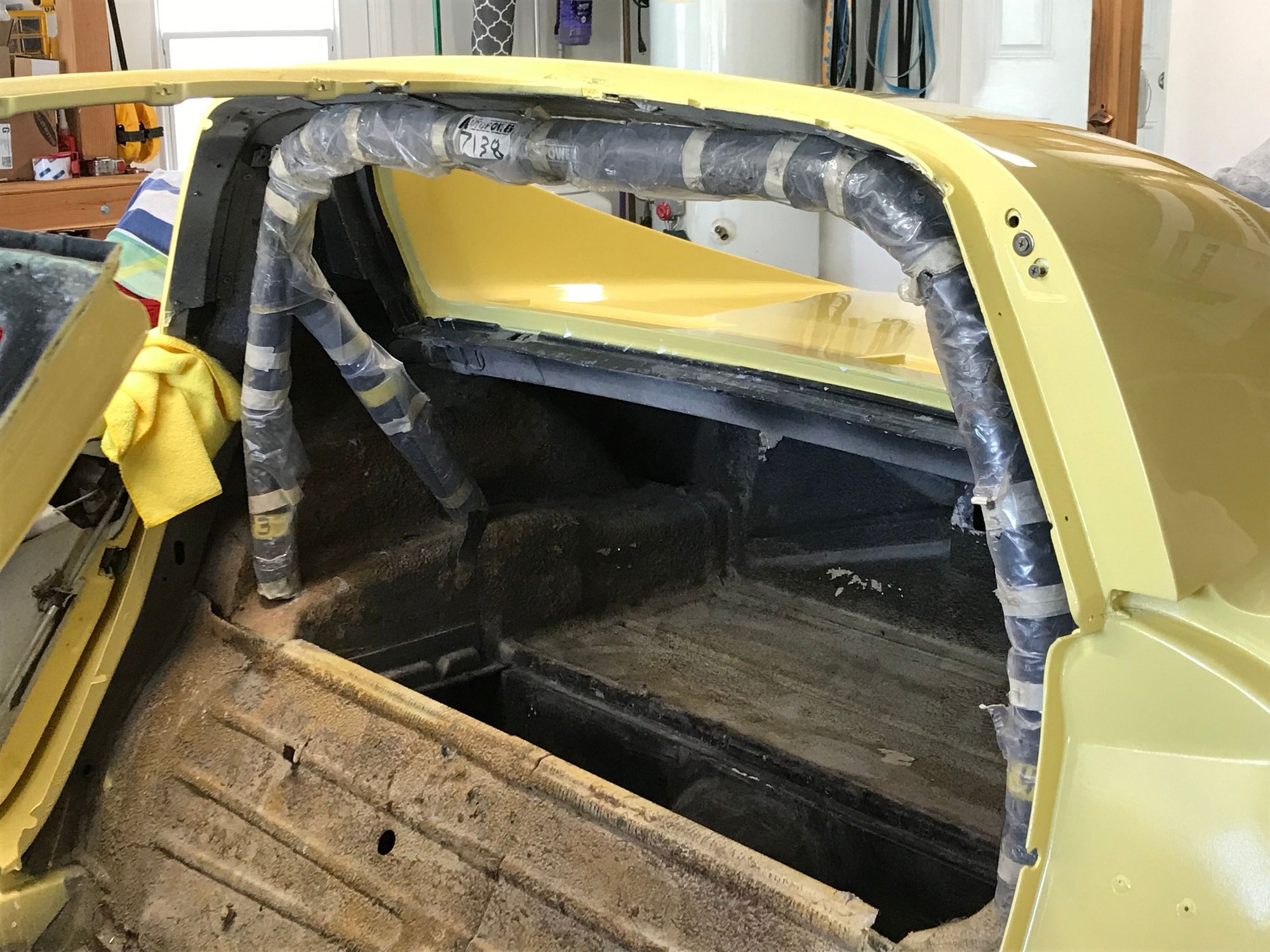

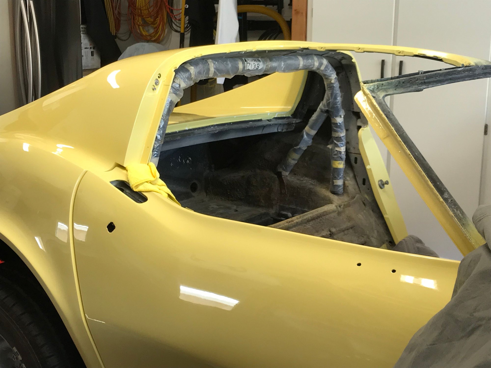

All the interior is out of my Coupe and I’m getting ready to fit the new roll bar.
I am trying to figure the amount of clearance I’ll need between the roll bar at the interior roof panels at both sides of the rear window.
I took a million pictures of my car when I disassembled it, but the two pictures I need I don’t have.
If you have pictures around the rear window on the inside of the car with the interior panels installed that would be awesome.
As you can see in the pictures I posted below, the corners of the roll bar contact the inside of the birdcage and I need to know how much clearance I need to clear these areas when the interior panels are installed.
Thanks!
Greg

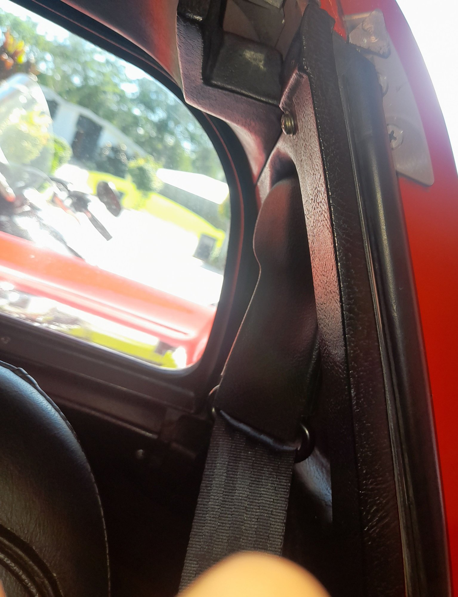

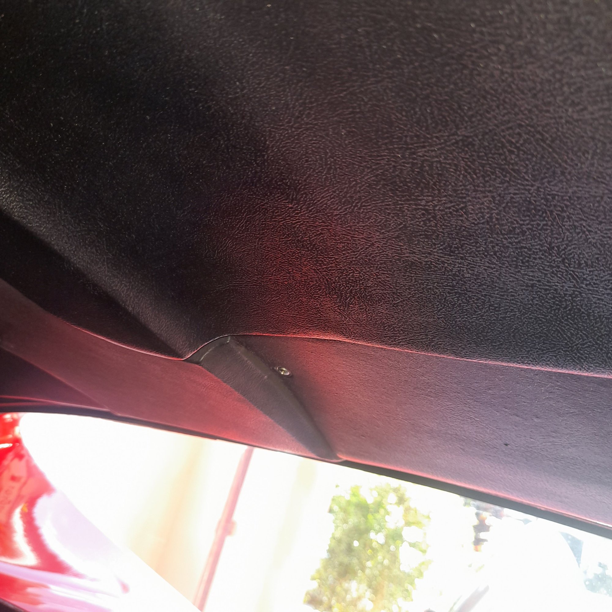

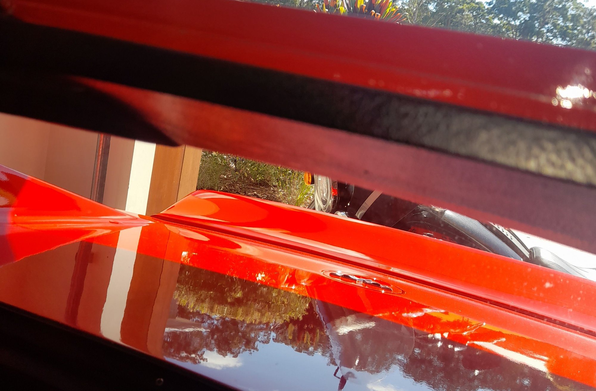

I'm at home recovering from the latest heart operation. So, I can go out to the garage and take whatever photos you might need. What angles of what I'm not really clear.
Old Apr 15, 2025 | 06:44 PM
OldCarBum's Avatar
OldCarBum
Posts: 14,407
Likes: 8,212
From: Napa Valley California
Thanks!
Basically the areas that I’m showing in the pictures I posted.
I’m trying to get an idea of how thick the interior panels are that install on the interior, across the top and in the top corners.
I would just dig out my old ones, but they are long gone.
How are you doing with your recovery?
You seem to be doing much better and we all hope you are.
I did enjoy the pictures you posted the other day, but you really shouldn’t attempt to 4x4 through the mud bog in the Corvette.
Thanks again!
Old Apr 15, 2025 | 07:56 PM
4-vettes's Avatar
4-vettes
Posts: 13,258
Likes: 7,848
Cruise-In VIII Veteran
That Mud couldn't have been 1/4 inch deep, geez.

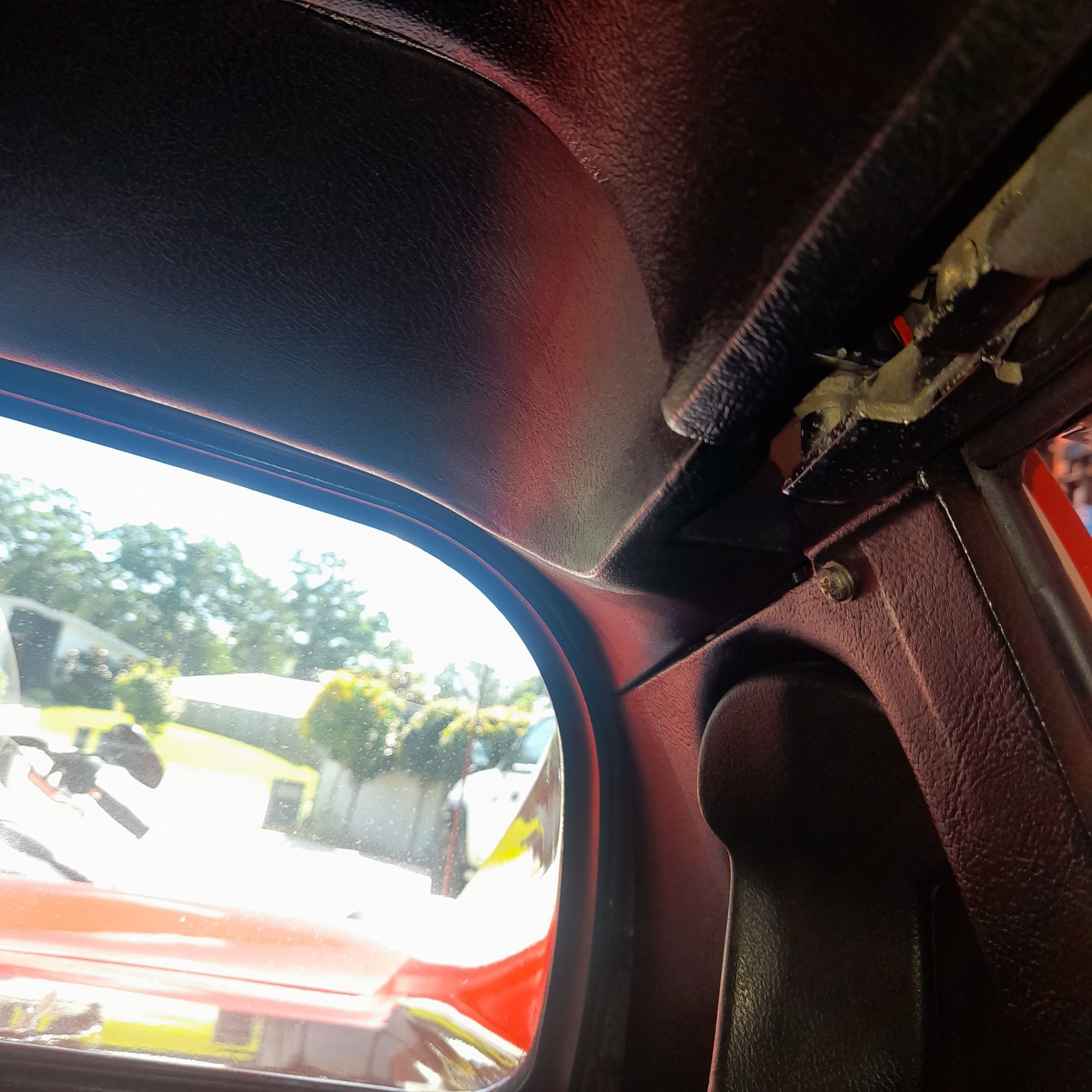

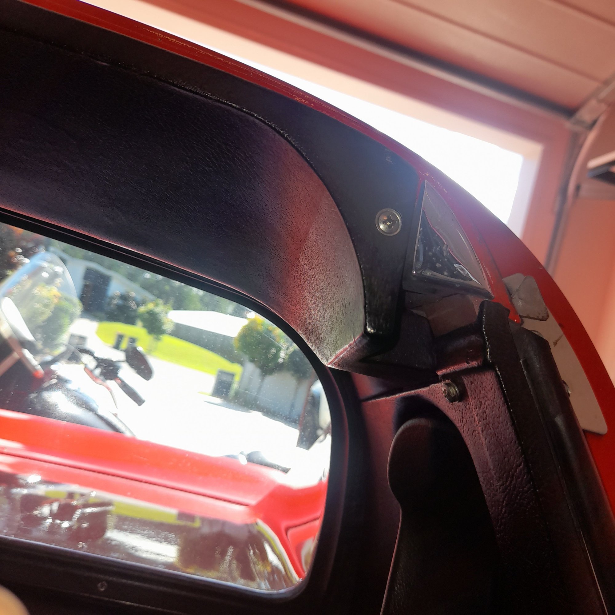

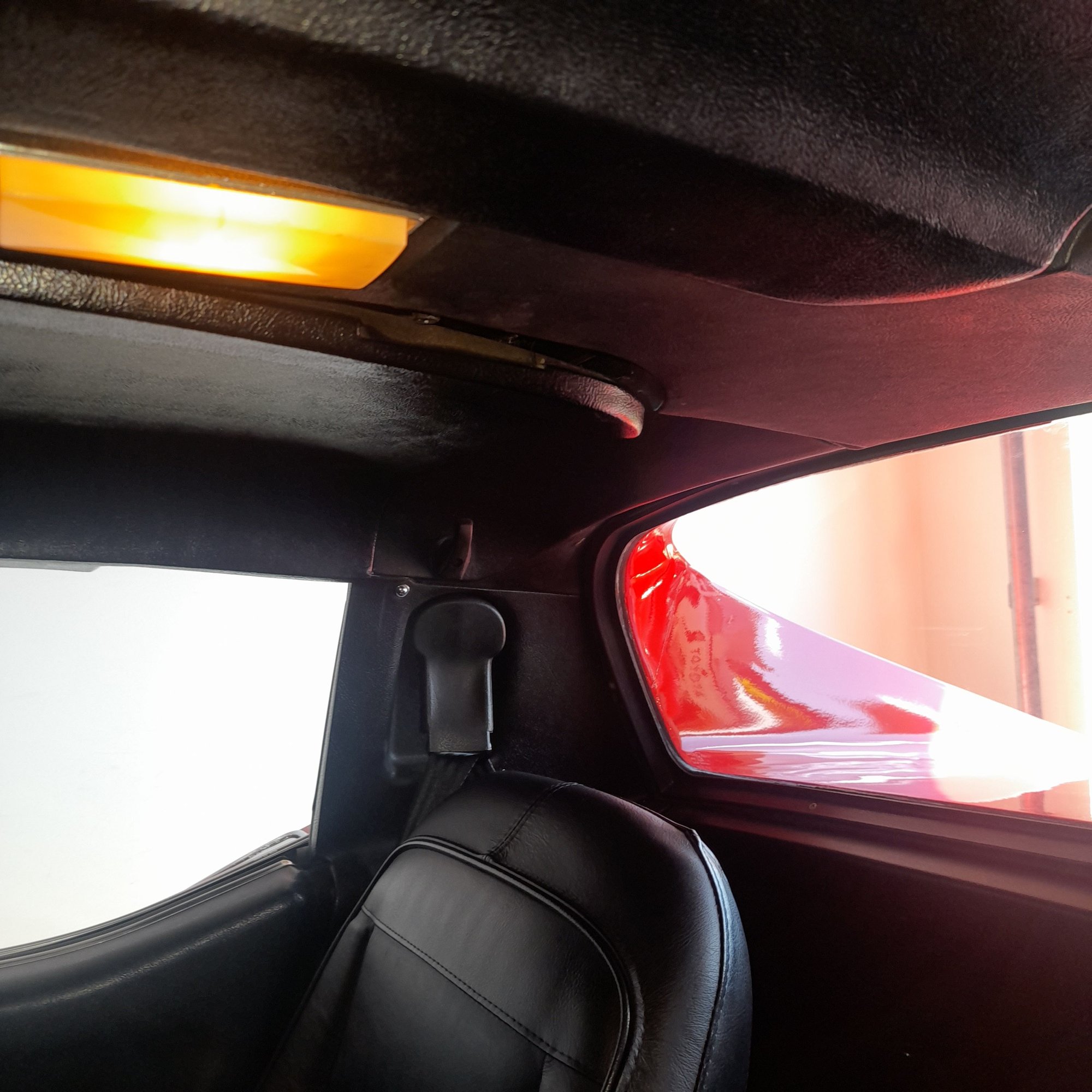

Anyway, some pics. Hopefully they will help. Those interior panels are pretty thick up in those corners.

Those are perfect for what I needed.
Now I think I’m going to wrap the roll bar back up, box the parts and wait until I get all the interior parts and pieces installed before I attempt to cut, fit and install it.
