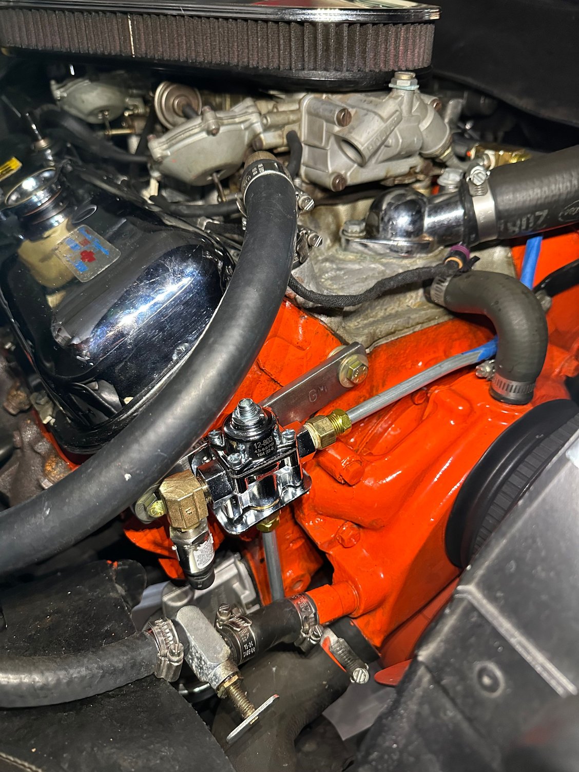

Just replaced the fuel pump on my ‘68 427 and I did have a pressure gauge installed. The pump I received from Zip Corvette was from Carter and it put out 9+ lbs of pressure. I only ran it for a couple minutes but it was obviously flooding the engine. After I shut it down I walked behind the car and saw a cloud of smoke wafting across my yard, another sure sign it was flooding the engine.
Awhile back I installed a Carter “high volume” pump on my Dodge and it put out the same pressure. I installed a Holley pressure regulator on that and it held like a rock at 6 lbs, ran perfect afterward.
I’m presently installing the same regulator on my Vette .
I’ve read quite a few posts about the pumps made today putting out excessive fuel pressure.
I’d be willing to bet you’ve got the same issue.
Wouldn’t hurt to mount a fuel pressure gauge installed in the line so your not in the dark on this. We have gauges for everything else in the car but this is as important as diagnostic device as anything else and not that expensive. You might find that you need to mount a regulator in the line between the pump and carb. Again not that hard or expensive to do.
That is unless you’re super picky on how everything goes together.
Below is a mockup assembly of my setup I took today. Should have it together on the next day I can get back to it.

Old Apr 18, 2025 | 10:22 AM
CiCiC3's Avatar
CiCiC3
Joined: Aug 2011
Posts: 429
Likes: 24
From: Charlotte NC
Interesting what you did there. I guess I don't have too mush fuel pressure it was actually a leak in the fuel line next to the carb where the mechanic tugged on it from below and then didn't check for anything on the top side coming loose. But I am interested in installing a fuel gauge and do something with getting a better in line filter.
I also noticed what looks like a shut off valve for the flow to the heater core? Not a bad idea! Every year I switch the hoses to loop back around in the summer to stop the excessive heat from the heater core in the hot summer. But that would save a lot of effort changing hoses! excellent!
Old Apr 18, 2025 | 06:39 PM
HeadsU.P.'s Avatar
HeadsU.P.
Joined: Aug 2017
Posts: 8,336
Likes: 2,810
From: Cool Northern Michigan
I have one exactly like that. NAPA, around $27. I think it looks more automotive than some.
I hid the valve down near the starter area just before the hose enters the heater core. But still has easy access.
NAPA will want to know if you want a 3/4" or 5/8" valve.
Old Apr 19, 2025 | 10:00 AM
0311 jarhead's Avatar
0311 jarhead
Veteran: Marine Corps
Joined: Sep 2019
Posts: 923
Likes: 155
From: North Port, FL
I got mine at Home Depot. Good selection and inexpensive. Less then $10 if I recall. You can get a small one and hide it under the hoses. I turn them both off that way I know no extra heat in the cockpit.
