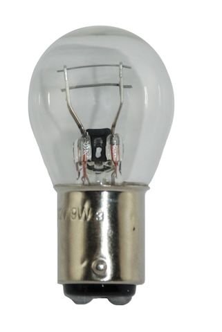

The tail "running" lights that should be on with the side markers and front parking lights are dual-filament bulbs. The brakes, turn signals, and hazard flashers use one filament while the running lights use the other. I'd check the filament integrity for both rear bulbs before doing anything else.
Bulbs should be #1157
ok thanks I’ll check that out. But I was wondering if off the top of your head if you knew what color the running light wire is?

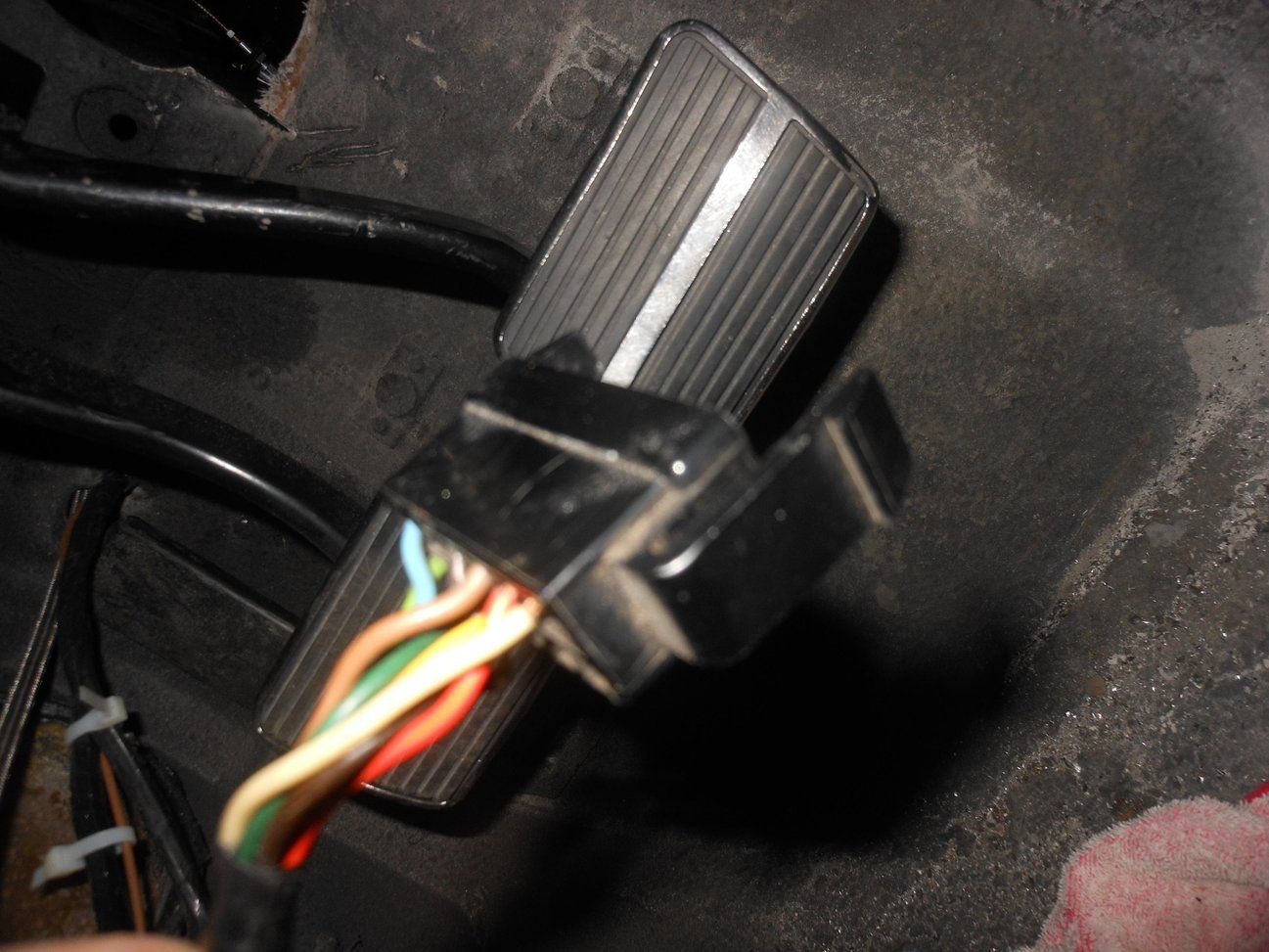

What year? Do you have parking lights in the front of the car? Are the rear sidelights not working as well?
Sounds to me it could be at the (not sure of the newer years) 12 pin connector right at the fusebox- which connects to the rear harness.
The brown wire is for the parking lights- I'd check and make sure you have power there.
this is the connector on a 71
