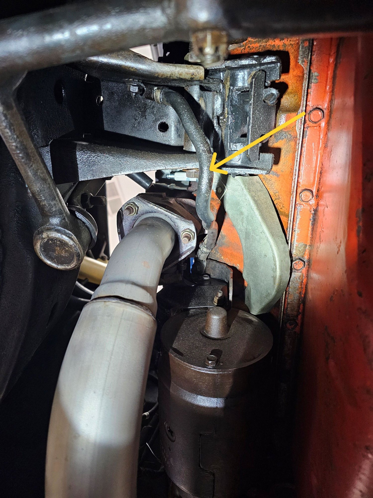

Sounds to me like your maybe missing the grounding cable from the block to the engine. When this is missing the power will use anything to get a path to ground.
That could be the reason why sometimes you have spark and sometimes not. The ground cable usually goes from the block at the back end of the starter (attached with the support bracket) to the frame near the RF suspension (If you have an AIM it's shows the location there.)
Also check to ensure the distributor is getting 12v while the key is in the cranking position.

The cable OMF is talking about

Thanks for the responses - will check this out as I did have to remove the starter when I was putting the new wiring in so I may have screwed up the grounding cable

Checked ground wire and all good - checked distributor and in same place before I started the rewiring- will check my wiring again

May want to connect a jumper cable from the battery negative to the engine block and see if that makes any difference. With that you can determine if its a ground problem or not.

I thought the ground was good when I tested for continuity but tried the jumper cable to the block from the battery and definitely made a difference, also noted that the wire into the distributor did not appear to be well attached so corrected that. Now I have the engine turning over normally with a spark but still not starting - have tried some starter into the carb and every now and again it catches as if about to start then nothing. As far as I can tell the fuel pump seems okay but would that be the most likely culprit - will continue my investigations
