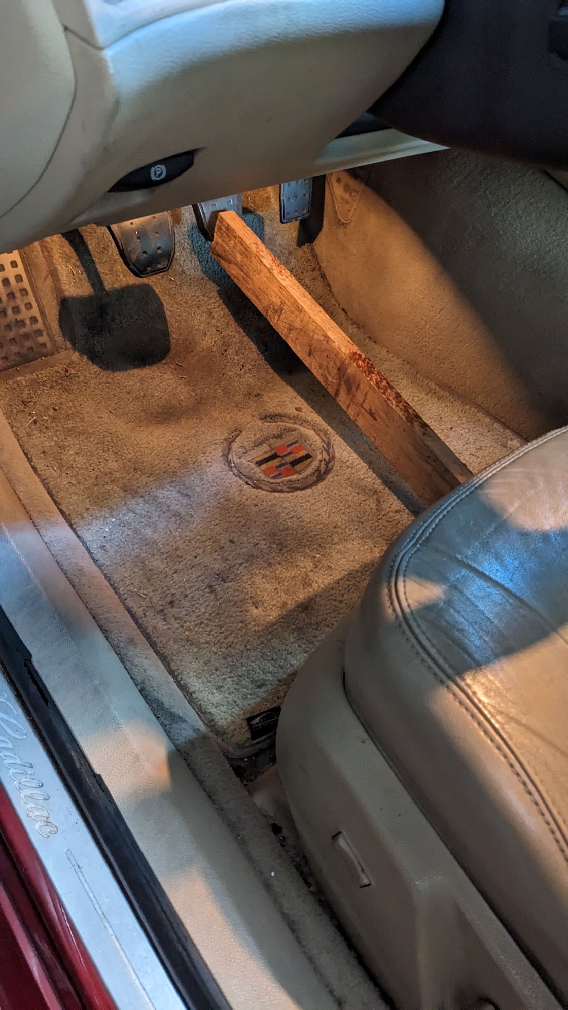

This is a new one I just found. When you take the calipers off, it is always a leaky mess right? No more!. Push the brake pedal an inch or two, and it closes the vent hole in the Master Cylinder, and if air can not get in the top of the hose, gravity will not let it leak out the bottom of the open flex hose. Not by gravity anyway! Sounds simple, but it really works. I have always been concerned about causing internal brake line damage by pinching it shut, to prevent causing a mess, but now you do not have to do that.
That is all it takes to stop the brake fluid from dripping out of the open flex hose, once the caliper is off.
An open Flex hose will not drip while prop is holding the brake pedal.
Testing for flex lines blockage
The above trick works in reverse if you loosen the prop on the brake pedal. It should start to flow immediately and steadily. Several drips per second means you do not have a blocked / collapsed flex hose.
Brake line with steady drips confirms no hose blockage.
