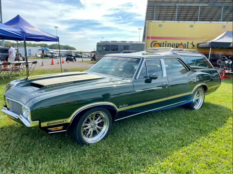

Yep- and I fully admit I have a problem... that's the first step isn't it?!!!
Thanks for the heads up- now Ii just need to buckle up and finish my current projects!!!
Saw this 10 years ago on the Hot rod Power Tour- always on my bucket list!

haha. I knew I liked you!! I’d be in trouble if that was for sale and in my range.
