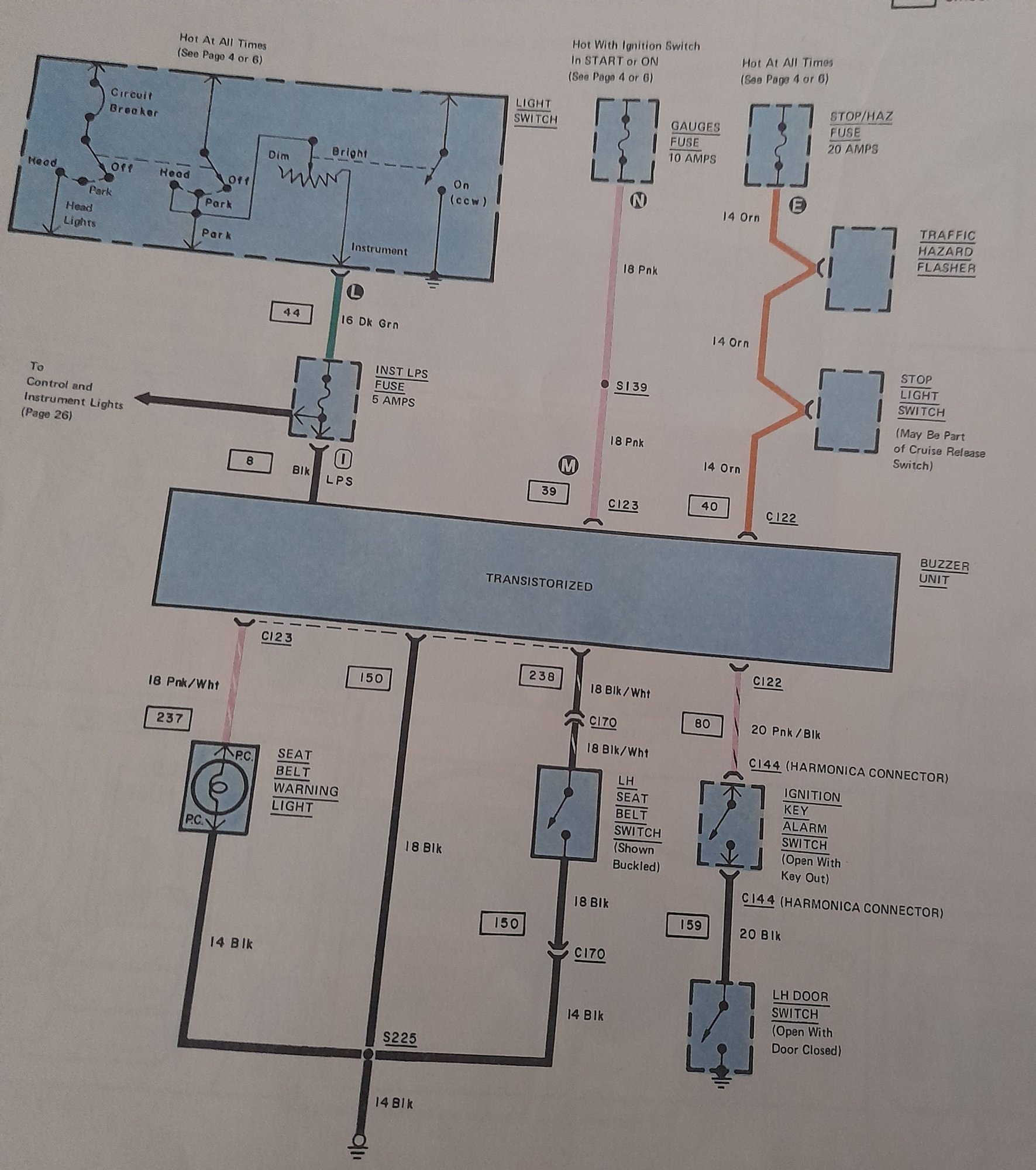

I'll try help here but my car is older, so likely somewhat different. I can't understand how the seatbelt warning light has anything to do with it. But perhaps it is just a sign that circuits are not getting power?
here's the 77 wiring for the seatbelt warning light.
I'm also uncertain as to what a column switch is. Ignition switch is mounted to the top side of the column just inside the dash panel. Basically above your feet. The part you put a key into is just a cylinder that pushes and pulls things mechanicly.

The seatbelt warning light is just a warning, the warning buzzer only controls how long the light stays ON once the ignition switch is turned to the run or start positions.
The off delay time for the lamp is between 4 & 8 seconds.
